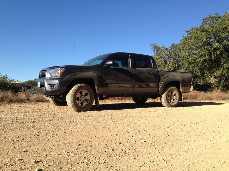

    hi...first post here...
    had the 2015 (9k miles) out for the first time today on easy/moderate 4WD trails. i noticed a repeated "clunking" sensation/sound being transmitted thru the steering column/wheel while travelling like 10 mph over intermittent grapefruit size rocks. my question: is this normal for this truck, or should it be checked out? the highway ride home was just fine - rode normally and smooth. i'm coming from a 1994 toyota 4WD which did not do this.
    any pearls of wisdom? thanks in advance!
