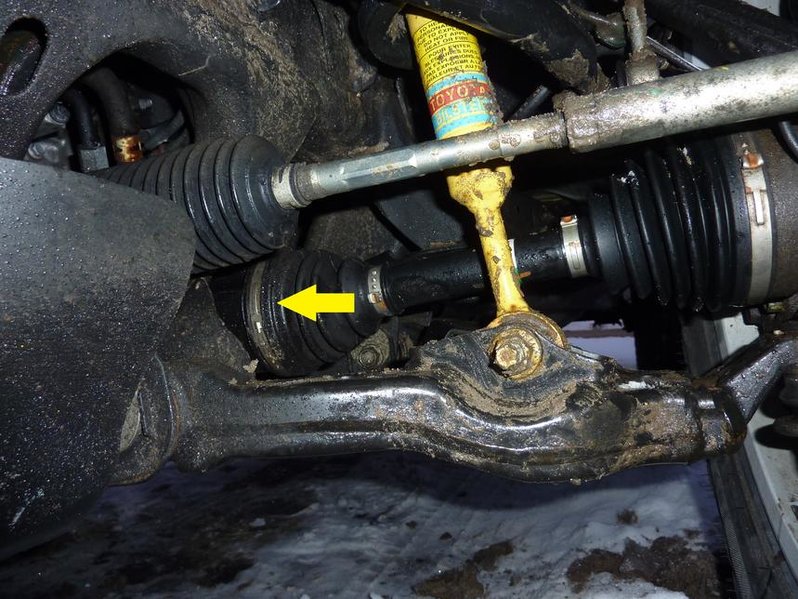

    I took a look today, I couldn't jack up the front end like I wanted to because we got some more snow today, but I had a good look at things. I don't think it's my mudflap, I did remove some ice from around it though. I pulled on some of the suspension components to see if they were loose, they all seemed ok to me.
    But I pulled on what I think is a component of the 4wd system (not sure what it's called, see picture attached with arrow) and gave it a shake and it had some play in it and clunked around a little. I checked the same thing on the passenger's side and it had no play in it and did not make a sound at all.
    Oh and I really didn't hit a snow bank, I drove through/went over a mound of about 18" of snow near the end of my driveway with the driver's side front wheel as I was reversing out of the driveway in 4wd. I think I will take her into the dealer tomorrow to show them. Any thoughts??

    I have been noticing a slight clunking/banging noise, not much louder than my exhuast at idle, coming from the front driver side on cold morning starts, usually if I haven't driven the truck in a day or so. No idea what it is, but as soon as the truck starts warming up it goes away.
    I'm in FL, so no snow. It's been in the low 40s and 30s here, so I guess ice is possible but yeah...
