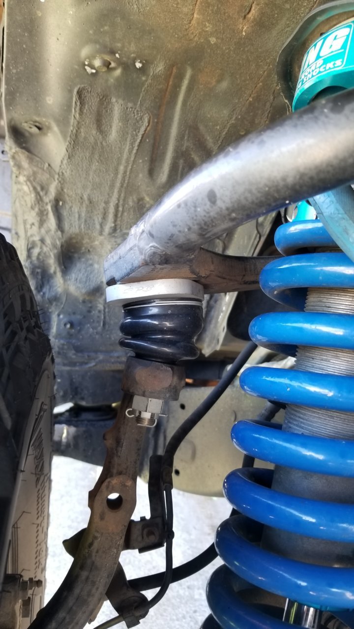

    I have a 2011 tacoma and I have noticed that the front suspension makes a clunking noise whenever going over road gaps, potholes, bumps etc. I have king coilovers with SPC upper arms and just replaced the upper ball joints and inner tie rods but still its makes the same noise (I'll post a video to this soon). The noise sounds like metal on metal clunking and is really annoying especially offroad! Could it be my lower ball joints or something else? Any help is much appreciated. I have 95k miles and the lowers have never been replaced.

    Here are some pictures of my front suspension

    pictures at full droop might be helpful.

    I don't have a jack on me to get that picture for you today
