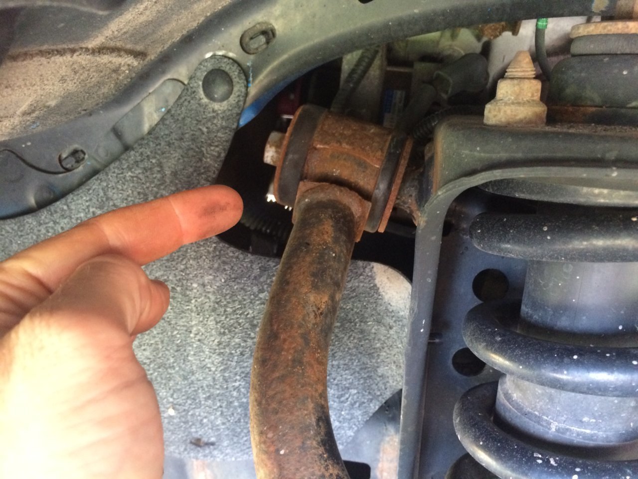

    Doesn't look like he is running a sway bar at all (I see holes where the sway bar end links would go.)
    Have you checked both skid plates (if you have the TRD skid plate too.) I have a similar noise coming from mine, but it almost sounds like a big metal panel is moving around, like a loose skid plate....

    S
    Sway has been gone since I owned the truck

    I
    I have Pelfreybilt differential skid plate and it seems right on there but maybe I'll yank it off and see if it helps. Would coils topping off sound that loud though if it were the coils? That seems as little excessive
