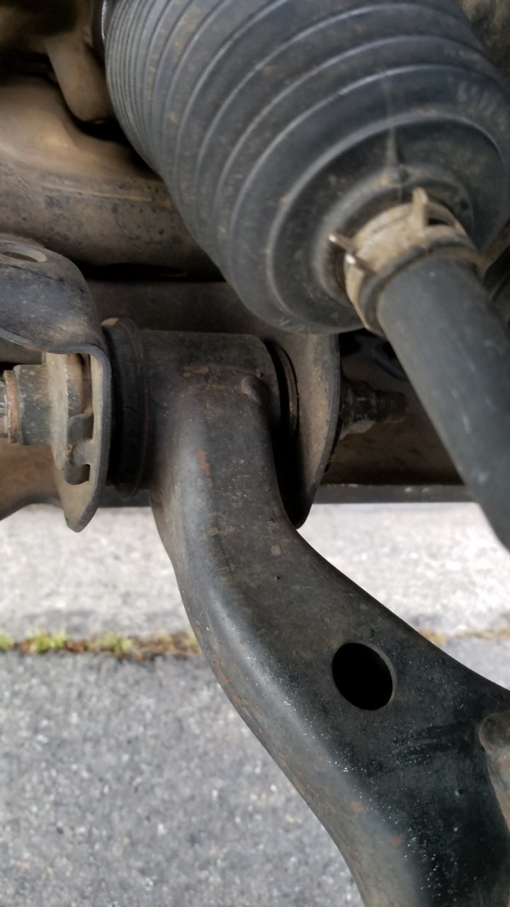

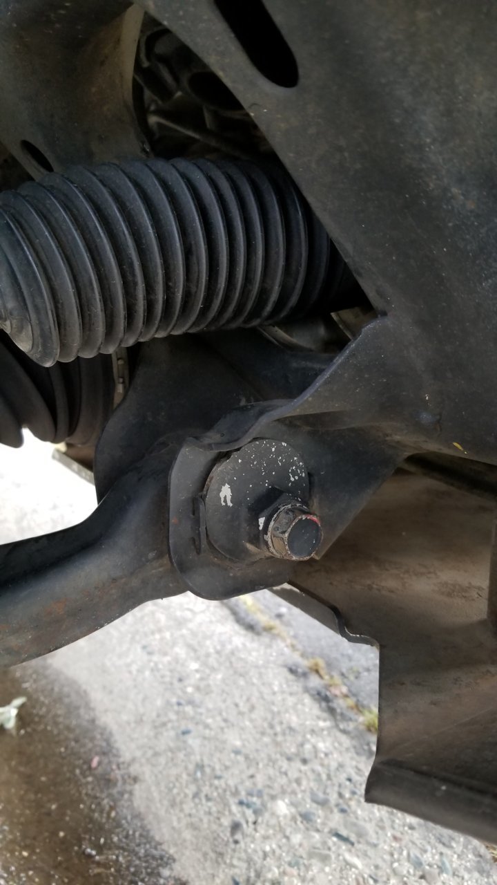

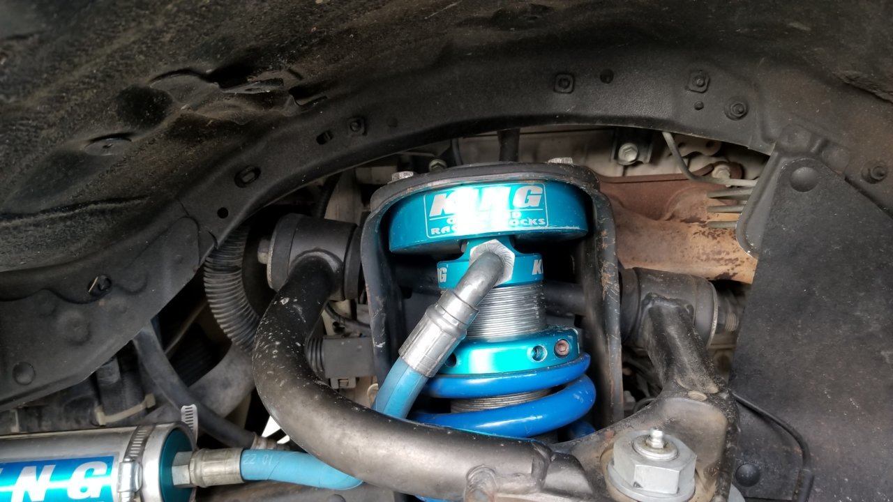

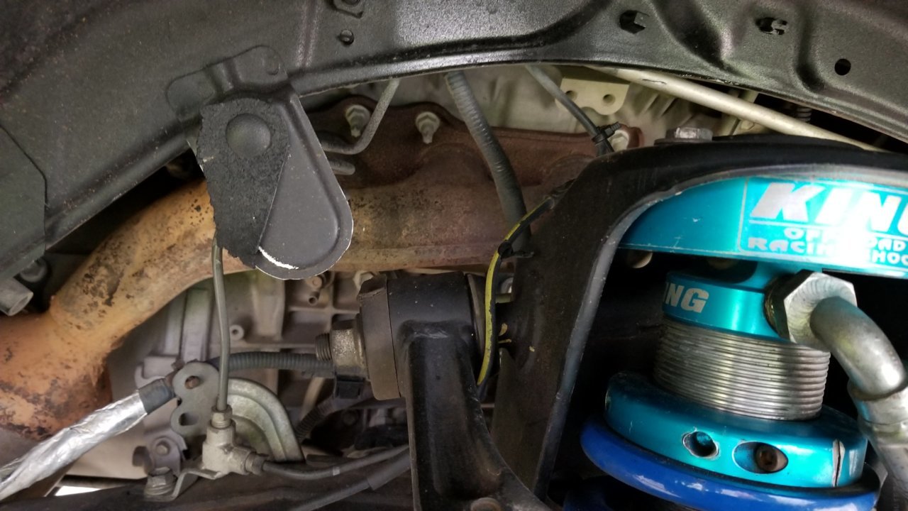

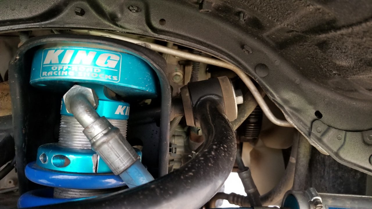

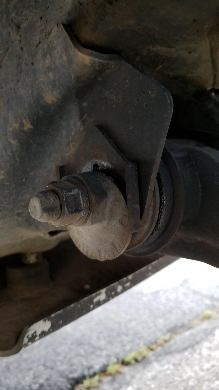

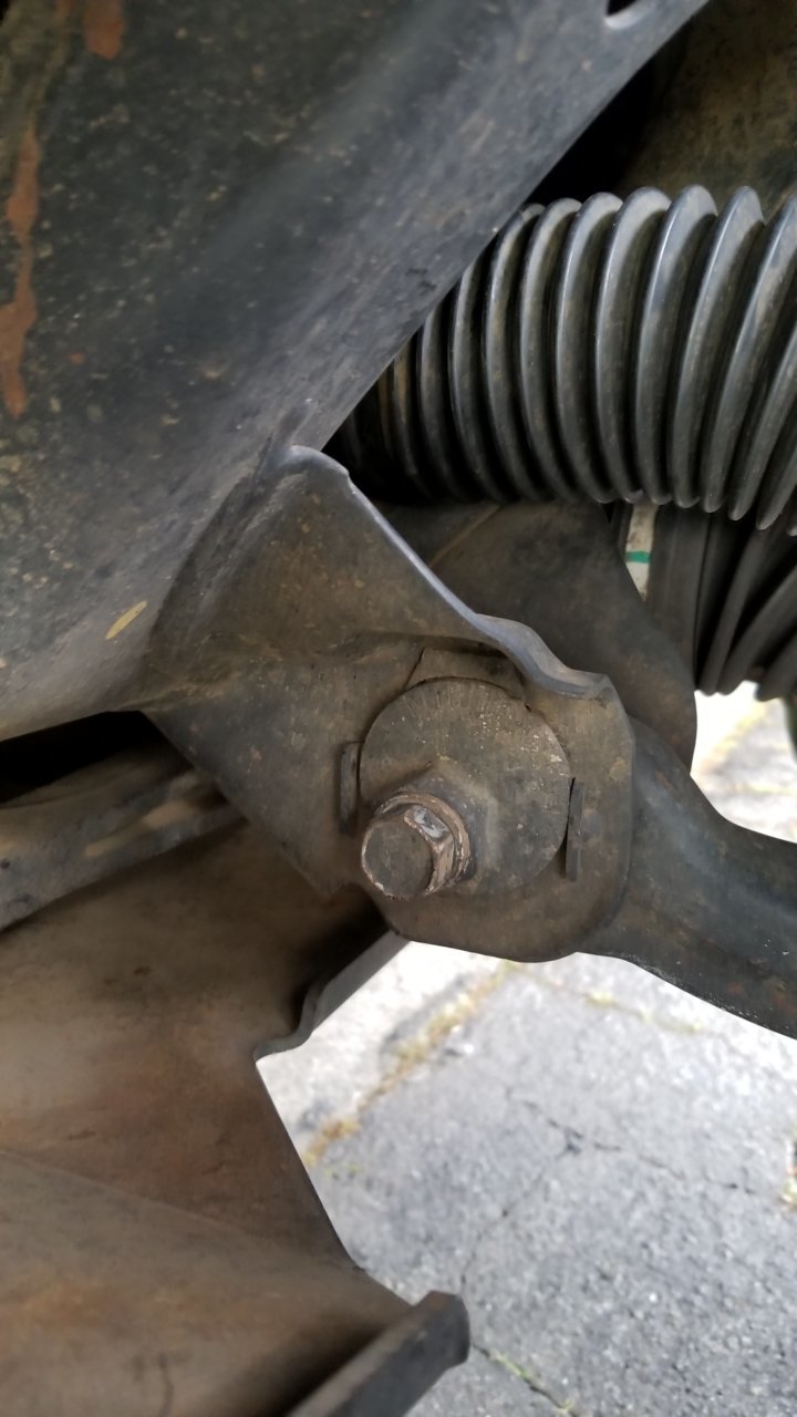

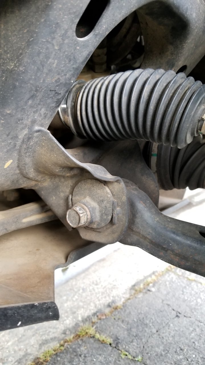

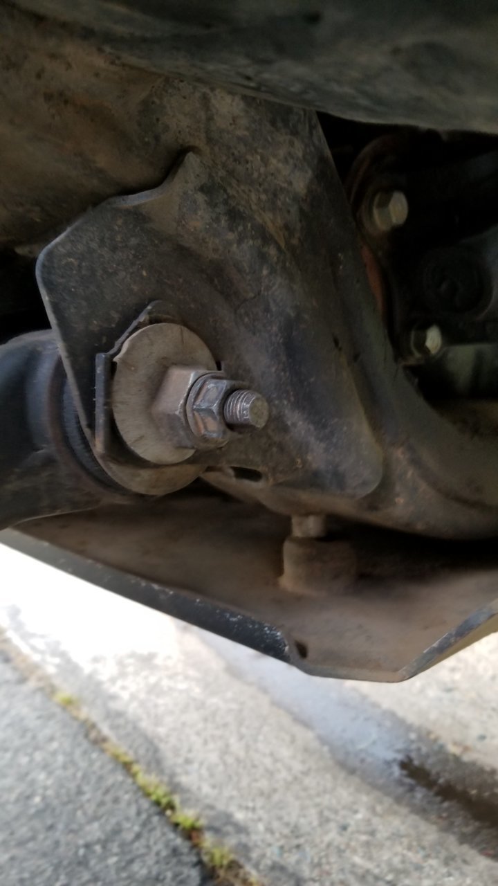

    Sorry for the long message but here is a shot of the suspension driver and passenger side

    20180416_184402.jpg this is most likely your problem

    Those are camtabs correct? What is their purpose?

    They are what set the alignment. Camber, caster. That one is way out of its home. Looks like its loose.
    Edit. Time for new hardware and bushings with lower ball joints

    I knew something was wrong with that one. I'll get that taken care of asap. I'll also have them retorque everything nice and snug

    Do you have a 19mm wrench, or 21mm? (Can't remember at the moment..)
    Check them yourself! That one that's upside down does look suspect

    To me it sounds like the skid plate.

    My bet is skid plate, I had the same noise and realized that the previous owner did not reinstall the spacers that go in between. This cause the most annoying rattles and bangs.

    I am running the Pelfreybilt plate bumper as well as the differential skid plate and yesterday I went under the truck to check the diff skid and it seemed pretty snug and tight to me unless its moving in a way that I cant move it while the vehicle is moving. I guess ill have to take it off today after work and see what happens when I drive it. Also I need to adjust that one camtab that is upside down and not in place right and see what that does as well.

    Your rack boot is off

    No the dust boot that is on your rack and tie rod has slipped off of the rack on the back side. You need to side it back and hold it in place with a zip tie or another clamp
    6th pic down
