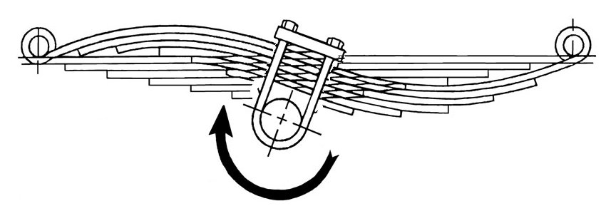

    This is pretty typical for older Tacoma leaf springs. They were never great, even when new but as the miles pile up, they get weaker and weaker.
    Here is an image that shows the energy the brakes transmit to the springs. The rotation of the axle during braking becomes more pronounced with age and harder braking. The noise is the release of this binding, when you let off the brake pedal.
    This is what is commonly referred to as axle wrap.

    Wow, this could be what I experience sometimes when I stop quickly (hard braking) and once I am stopped at a light, there is a clunk and it feels like I am bumped from behind by another vehicle, but no one is there. Could be the leaf springs unloading from axle wrap ?

    Yes, this is very common. The braking causes the springs to curve, forcing the pinion downward and extending the driveshaft splines. If these splines aren't EXTREMELY well lubed, it tends to stick in this position until you let off the brakes/apply the gas; the splines break free and the pinion pops back upward. This is the "clunk.'

    No worries. Drove me crazy for awhile trying to figure out where it was coming from.
    Lift springs tend to help a bit, but even with my OME Dakars with the extra load leaf, they still do it on occasion when the splines get dry. Only real way to fix it is to eliminate the axle wrap with a traction bar, IE BudBuilt's: http://www.budbuilt.com/index.php?p...tegory_id=23&option=com_virtuemart&Itemid=170
