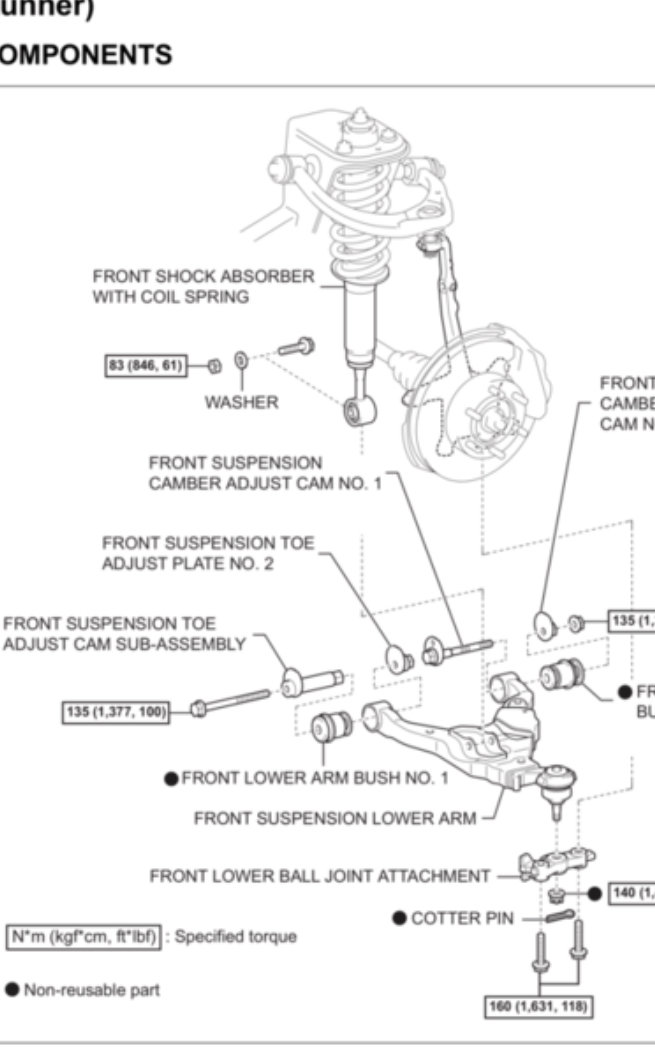

    The lower CA bolts are known to loosen up. Check them, they may have already been loose. The silicone might have just made it slick enough for it to finally clunk.
    Mine would clunk under hard turns.
    And more often than not at full lock in reverse.
    Island Cruiser likes this.

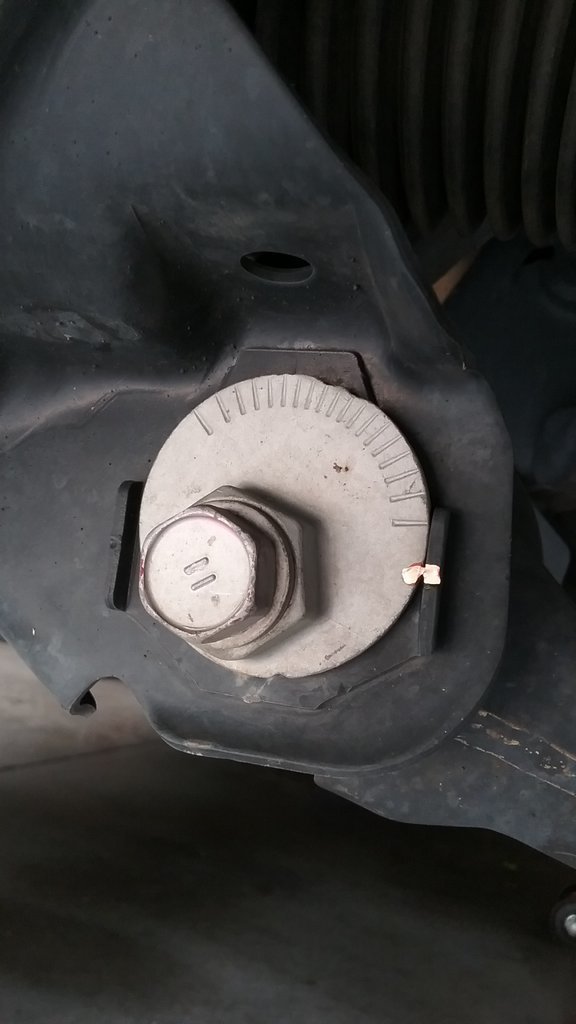

    Could you take a picture of what you are talking about

    LCA/Alignment cam bolts/nuts need to be torqued to 130ft#'s or else you will experience popping sounds. Get your toeque wrench out and make sure they are tight.

    It is the smaller out side bolt.

    I think it’s 100 ft/lbs.

    There was no tightening to it

    Yes, factory spec is 100, not quite enough. 130 gets the job done better.

    pretty sure its the alignment cam bushings going bad the start to give away from the cam alignment shaft and move around making that clunk, mines doing it too on the passenger side, silicon spray quiets them up for a while
