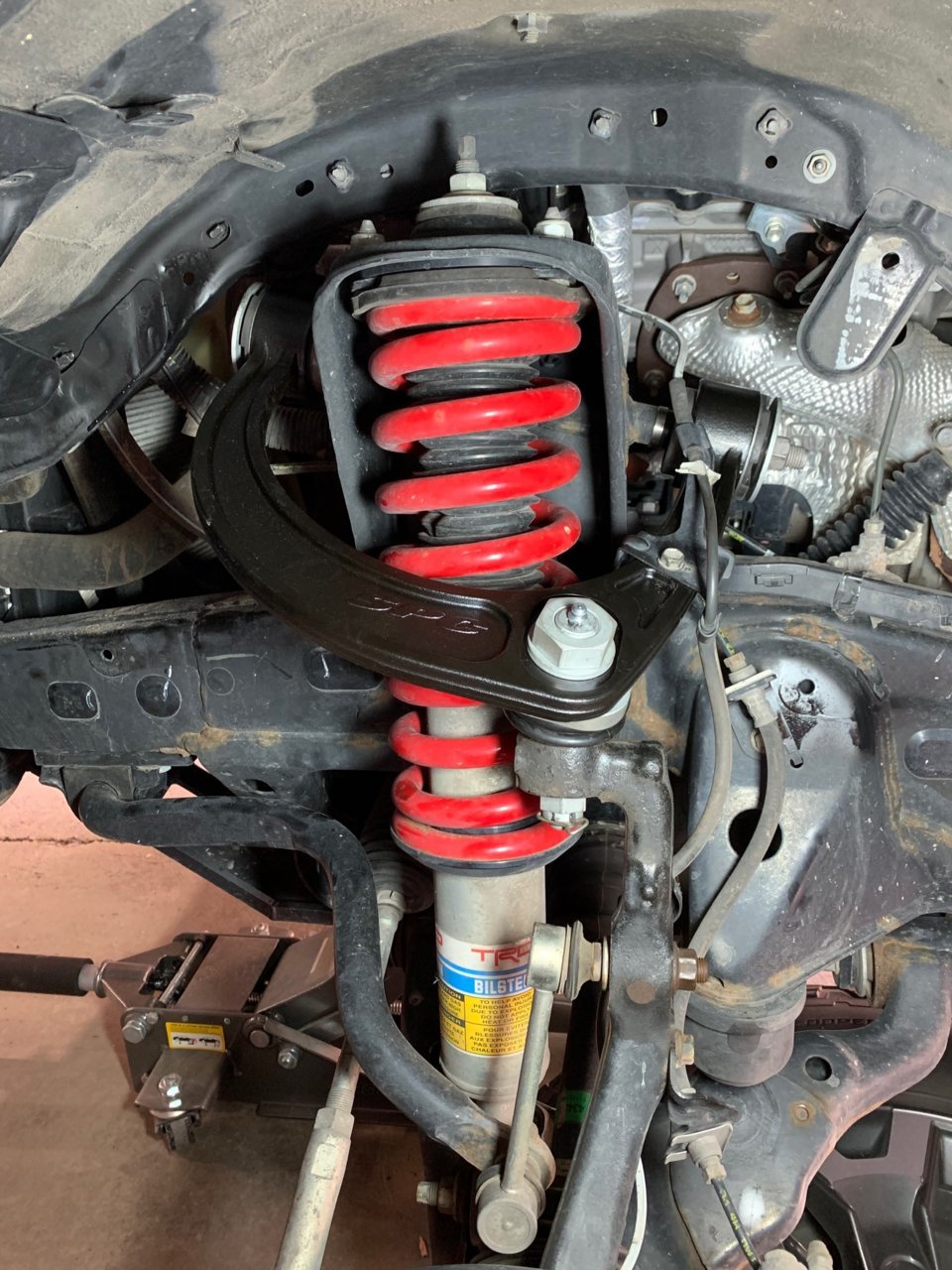

    I’d just torque the nut side if you can. If you can’t for clearance or some other reason, then at least do the bolt side while holding nut side (not trivial without a lift to stand under).
    I did SPC’s from @HeadStrong Off-Road. Been battling alignment issues off and on after my 2” lift and decided it was time to get things dialed in before I get my next set of tires.

    Looks great man. I’m running those same bumpstops. I have JBA UCAs rn, eventually going to step up to spc or camburg...
    BortisYeltzen[QUOTED] likes this.
