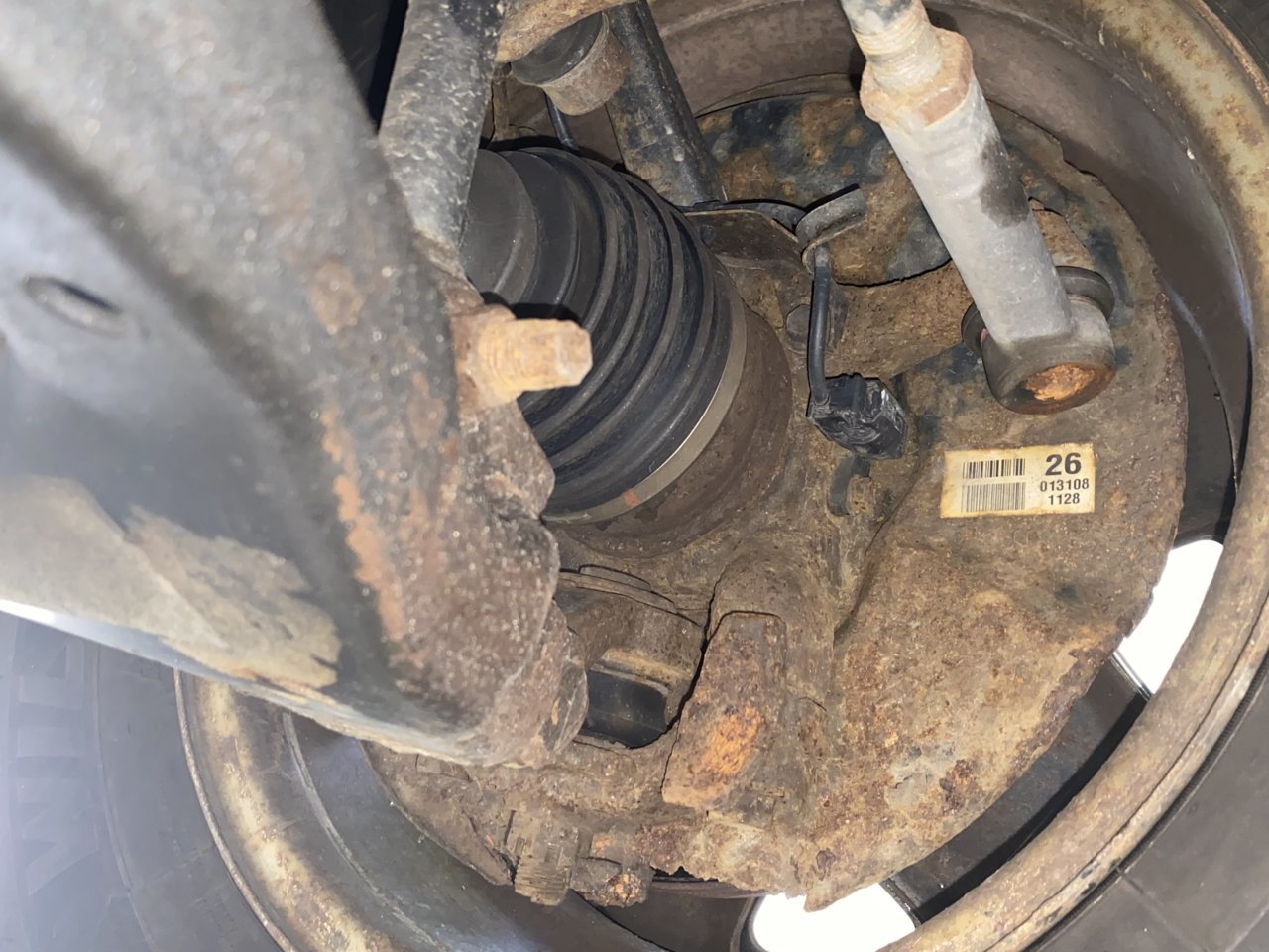

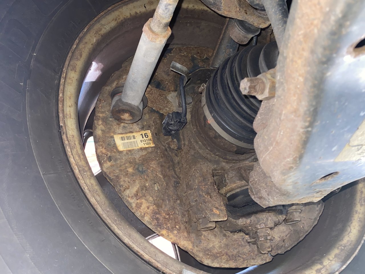

    Hey all, I'm slowly but surely trying to fix all the wrong with my truck. I don't know much about the history of the truck. What is apparent is the rust and that it likely has been a Maine vehicle or lived somewhere in the NE all it's life. The previous owner clearly didn't give two Fs about it. My guess, and let me say I'm not mechanically inclined, but not afraid to get into the simpler projects, is that maybe it's the part pictured below? This is looking at front left and front right wheel wells while laying between the two. Any thoughts on what might be causing the clunk at low speeds? Otherwise the brakes feel fine except for a bit of a lurch when coming to a complete stop, and then again when accelerating from a stop. Rotors and pads feel fine, there is a small squeal when reversing out of my parking space. If I can think of anything else I'll try to update the thread. Let me know if more pictures are necessary to give a good diagnosis.
    Replacing the U-Joints and Center Support Bearing soon! Thank you so much in advance for this wonderful community and all of your helpIMG_1570.jpg IMG_1571.jpg !!!

    I'm in an urban center. This is Maine though so even Main Streets are rough. My guess is it is the dust shield. Could be time for a front brake overhaul though.

    That lurch feeling is most likely the control arm bushings. And seeing how the driver side BJ boot is torn, I would replace all the BJ’s as well. With that mush rust, don't be surprised if the front cam bolts are seized. Also check the inner/outer tie rods for excessive play.

    If the clunk is from going over bumps or potholes, any of the ball joints and control arm bushings could be suspect. I'd start with whatever is leaking first (i.e. lower ball joint in the photo). To avoid costs spiraling out of control, replace the lower ball joint in-situ, without removing the lower control arm from the vehicle. Use Mevotech TTX, Moog, or TRW ball joint.

    My vision sucks, but is the boot on the lower ball joint in the second pic torn?

    Starting with the cheaper items, LBJ and Upper Tie Rod ends. Look like those are leaking too. Hoping this makes a difference.
