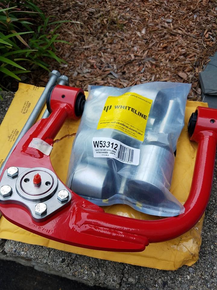

    Got the exact same thing and have JBA's sitting in the garage waiting to go on. Also doing all new Whiteline Bushings in the LCA's arms, and new alignment cams.

    Not even over leaves. I am only changing the LCA Bushings as a preventive, and the Cam's since it will be apart. I'm changing the to the JBA's as the Camburg's already have a damaged Ball Joint. So I am switching over to the JBA's as you don't have to take them off to switch out the Ball Joints. The Camburg's you have to take off every time you want to put new Ball Joints in, also I will get better Caster numbers with the JBA's
