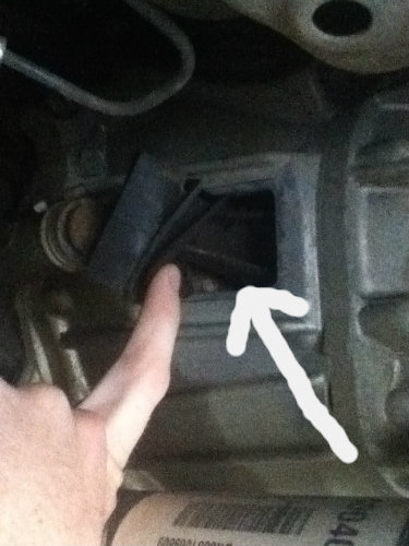

    I have the clutch squeak. I found it's not the pedal that squeaks but the noise is coming from where the clutch linkage goes into the transmission. Is that what's covered by TSB-0066?

    Your arrow is pointing to the shift fork. To the left of your finger at the tip of the slave is where it contacts the shift fork creating a pivot point that moves the fork. This is where most of the noise if coming from. You can see that end is rusted in the pic but the point is just a tip/ball end. It wears over time and can get dirt/rust there. Unbolt the slave and sand the tip a little. Clean the tip and contact point with something and put some heavy axle grease there and where it contacts.
    If this doesn't fix it then the shaft that the release bearing rides on may need to be re-greased. You can't do this easily without dropping the transmission. Perhaps the dealer can replace this rusted fork if it is really bad. Don't spray inside that boot.

    I have greased the fitting on the slave. It took quite a bit, but didn't solve the squeak. I got under there and had someone engage the clutch and I hear the squeak coming from inside the housing.
    Dang. Yeah, it's coming from inside the housing, not the slave.

    The rubber boot that I'm holding back with my finger fits back in the transmission housing around the shift fork, pretty much sealing it from debris and water.
