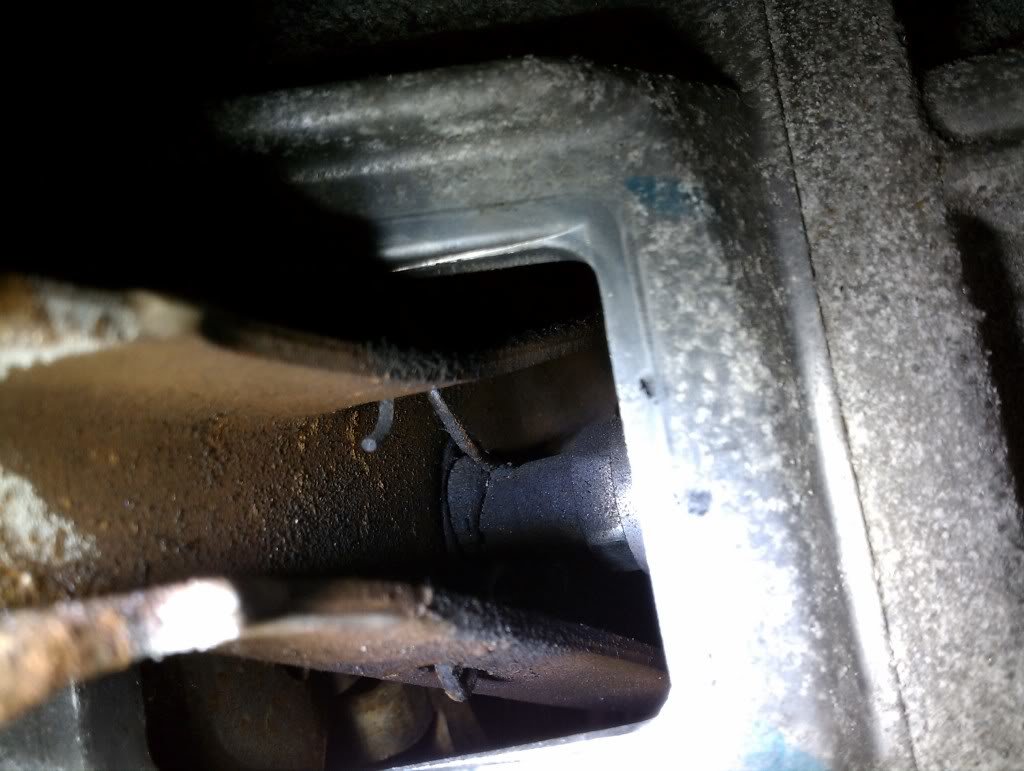

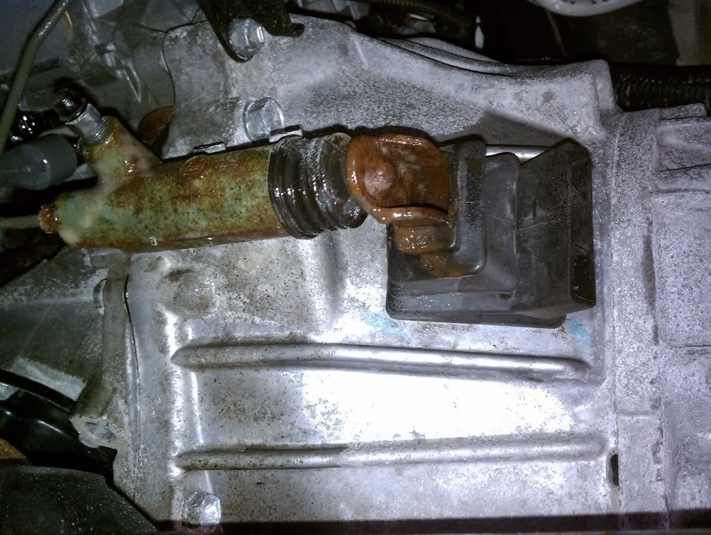

    Took some pics of the boot and fork on the slave. Tacoma_Slave_6f68f85abd21a2304e63cf9bbfe9ce95ab6a9cf8.jpg
    and inside with boot removed looks like a clip....all pretty rusty
    Gave it a shot with white lithium spray and see how it goes.
    Onto the pedal which is another story.....In the video you can see that rotating the shaft like so many threads describe only last until you press clutch pedal in. It snaps right back into position. This default position has a noise created every pedal press which I simulated by moving the shaft. I'm not sure what people are doing to get it to stay put.
    http://www.youtube.com/watch?v=DnobzE8wIH4?fs=1

    I spayed some wd40 where the boot meets the fork thingy, no squeak for 2 days....then it came right back.

    Your video is exactly what my clutch pedal does every now and then. The dealer replaced the throw out bearing and clutch fork on mine because of "heavy rust". The creak stopped. Then a week later, the rod between the pedal and master cylinder fell out because the nut wasn't tightened. Now it pops. Seems like a no-win situation no matter what owners do.

    ok i hate to beat a dead horse, but mine wont stop squeeking at the bellhousing. not where the slave arm pushes on the fork, but inside the boot. i spray pb lube in there and it's gone for a few days, then it comes back. any ideas on that? sorry if this has already been posted, i looked and looked and couldn't find anything....

    Toyota replaced my clutch fork, the pivot stud, and the throw out bearing under the "certified" warranty within the first 2 months I had my truck. They said the parts were badly rusted. Since then, no squeak from the bellhousing. Try some spray lithium grease. It's heavier and will provide more of a barrier than the penetrating oils.

    I gave every stupid thing a try in the cab. Turns out the problem was under the truck. 1 shot of grease under the rubber boot is enough to keep the squeak away for months.
