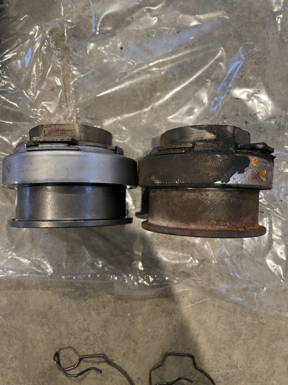

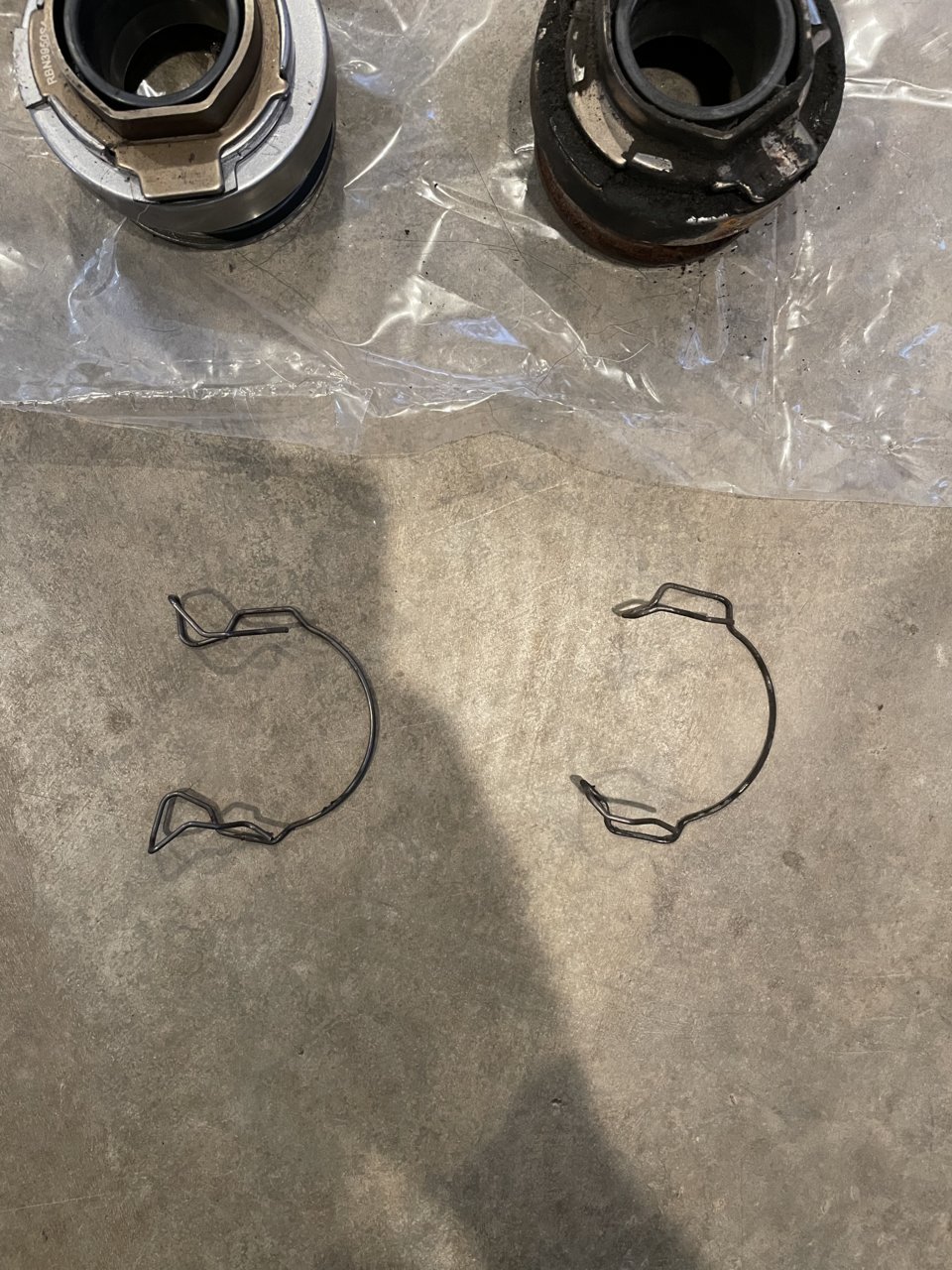

    Ok thanks I thought that what I saw but wanted to confirm. Next issue is the throw out bearing is shorter and the spring will not work. I saw a thread about the bearing being the new style, wondering if I could use the old spring…

    I had the same issue and had to swap the spring from my old bearing to the new one. The one it shipped with did not fit through the fork. I didn't notice different height in the bearing itself, but maybe I just overlooked it. Wouldn't worry about it though. Swap the spring and you should be good to go

    Ok sweet thanks kinda what I thought!
