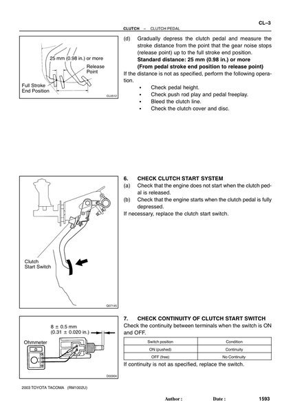

    might need to get out your magnifying glass, didn't realize how small the print would be, oh well :thumbsup:

    My clutch is brand new and it engages pretty high off the floor, not very far from where the pedal is fully up...I've heard that you can adjust it to 'bite' closer to the floor (sounds like what the diagram above is for)

    You can most def get it to bite closer, I adjusted mine to engage just over an inch and a half off the floor ( staying above the FSM spec)...most people immediately stall the truck who haven't driven it... but its how I like it, great for stop and go and crawling offroad. I took out the stupid squeaky oem clutch spring and replaced it with straight spring, theres a write-up somewhere on here on that, and that made my shifting experience awesome...added the URD short shifter and I've been in stick-shift heaven since
