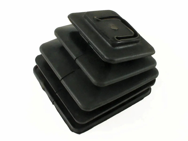

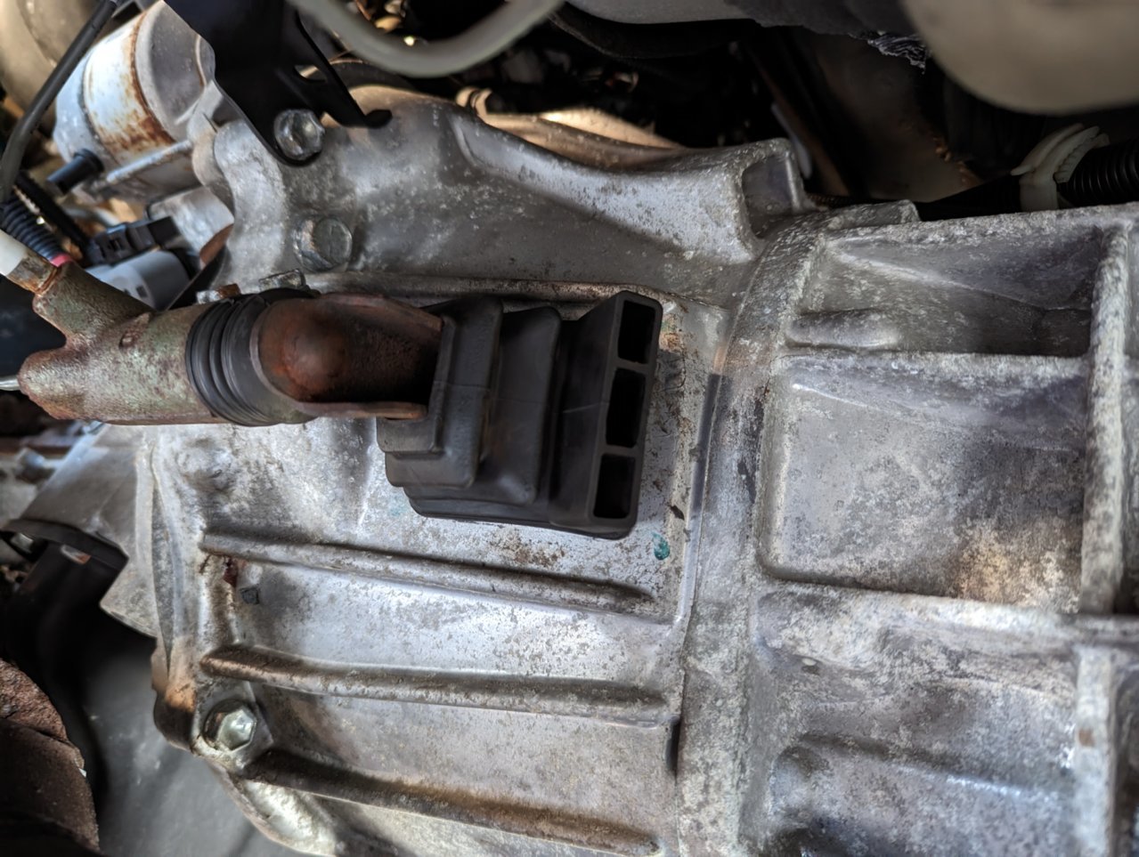

    Is there any particular reason why this boot doesn't create a better seal against the clutch fork? It seems like a likely spot for water ingress. Are there better sealing boot options or is this a necessary feature for cooling or something?
    I checked for replacement boots without the vent and better sealing against the fork. For instance, a 1981-1995 Toyota pickup boot looks like this. No vent and a perfect c-shaped cutout to match the shape of the fork. Seems better imo.
    Thanks all

    Water intrusion there is a non issue, the bell housing on most vehicles are far from sealed. If you’re in water deep enough to get into the clutch fork boot, you’re already getting water in there elsewhere. Most inspection covers don’t seal tight and many even have vents in them.
