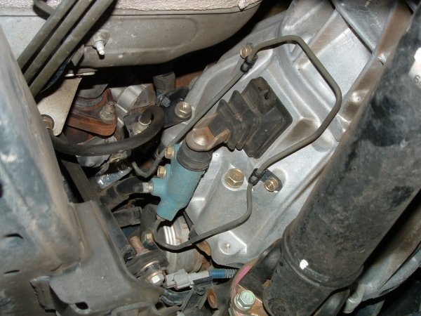

    I started replacing my clutch slave cylinder and master cylinder today and my hard line directly out of my slave cylinder has a bushing that will not spin so I cannot reuse the hard line. I have been searching for about 20minutes for where to buy another line but cant find it. Can anyone help me locate one? Thanks in advance!! here is a picture of the line I am needing

    most likely dealership is your only option. If you can wait for it to ship, can order from Camelback Toyota for a decent price.

    Judging by the picture , you should be able to unbolt the slave cylinder and spin the slave to unloosen it . Once the slave is off , an impact gun will get that bushing free .
    To add : hydraulic shops can make you a flex line from the slave to the master , just keep it away from the exhaust

    Awesome, thanks for the options! Didn't even think about using an impact. If that doesn't work, I will be having a hydraulic shop make me
    One. Thanks again

    Thanks for all your help! It would have gone even faster had that hard line not gotten screwed up. I ended up replacing the line with a braided line for the local hydraulic store. They built me one for $16 so I figured it was best just to replace it. I think I will adjust the rod and see if that does the trick. If not, I will replace the pedal spring with a linear one. Wouldn't having the new spring remove ALL free play? Dont we want 1/2" of free play?
