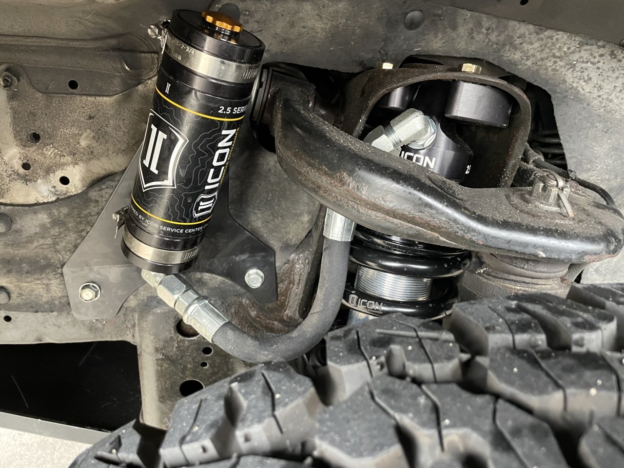

    thanks, you’re making me feel a lot better. I’ve already ordered the parts and have the job scheduled. So much of me has gone into building this truck, and I literally just threw an icon stage III on yesterday, so it’s disheartening that I have to do yet another job on when I could just be enjoying the new upgrades.

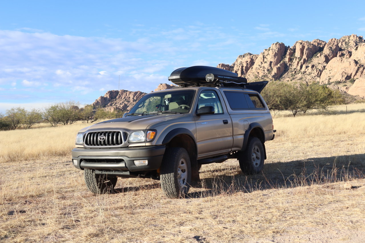

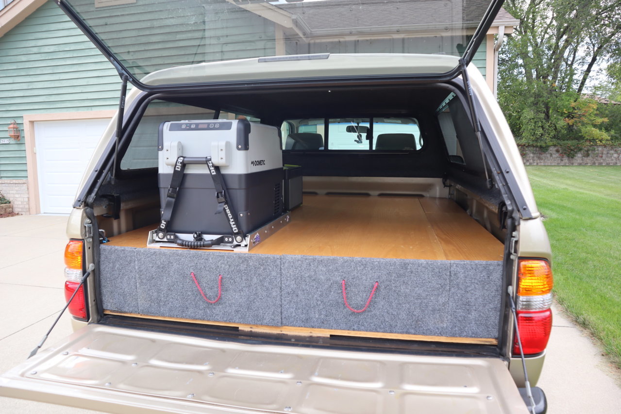

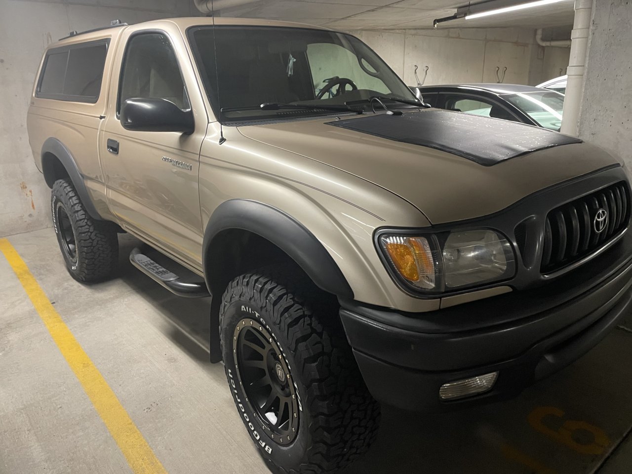

    Sucks, sorry to hear, I guess that’s how it goes. Mine is gutless too, haha. Here’s a couple pics, some before, some after my most recent upgrades.

    Hell ya man, looks in good shape. Even if down the road trans or motor dies I would just get it rebuilt or fond a good used. It is just in too good of shape
