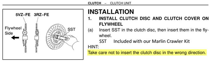

    Hello everyone removed clutch from 03 tundra 3.4l forgot with way it came out was wondering do the springs go flywheel side or transmission side thanks in advance

    I hope the pic and the PDF help, they show the orientation pretty well
