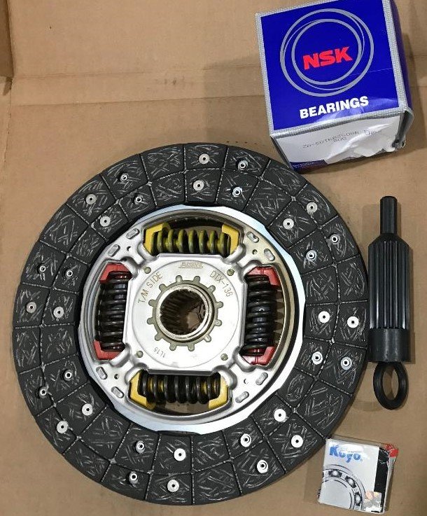

    Yes indeed! OP, glad you got it sorted out with a little help. The AISIN clutch disc I installed was marked backwards. The disc side that was stamped "T/M SIDE" needed to face the flywheel on the 3.4L 5VZ-FE engine. AISIN even included a love-note to that effect. I triple-checked my disc orientation so I would not have to pull the tranny w T/case.
    "T/M SIDE" on AISIN disc is NOT correct for the 3.4L 5VZ-FE:
    Proper disc orientation based on engine type:
