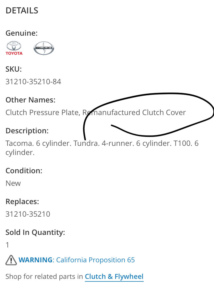

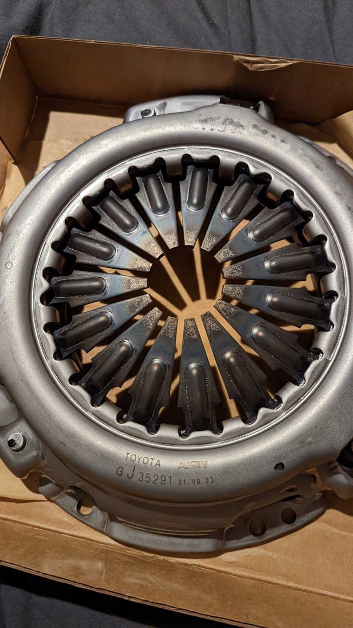

    For what it's worth, here's a pic of the remanufactured pressure plate I just bought from Toyota. Gotta say, I'd feel better about it if the fingers didn't still look so worn. Seems like of all the components of the part, those should be new.

    Thanks for the pic you posted of your reman pressure plate/clutch cover. I was considering going with an OEM clutch kit from Toyota. Price thru McGeorge is reasonable at $274 + shipping. But I mistakenly thought the clutch disc and pressure plate /clutch cover were "new" as some other sellers/dealers claim. But McGeorge Toyota states that they are in fact remanufactured, not new parts. Additionally, the OEM Toyota remanufactured clutch disc appears to have plastic spring dampers like the disc in the Aisin CKT-040 clutch kit. Both the EXEDY & Valeo clutch discs have metal spring dampers which many including myself prefer. Hence, I am still trying to decide which clutch parts to go back with. Like most, I want to get it right the first time. Just for reference, ShowStop over on TTORA recommends Exedy, Valeo, then Aisin clutch kits in that order. He also stated to be sure to go back with a high quality Japan throw out/release bearing even if it does not come in the clutch kit. The OEM Toyota T/O bearing appears to be a Nachi which I prefer. Marlin carries them along with high tensile clutch hardware. .02

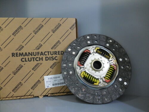

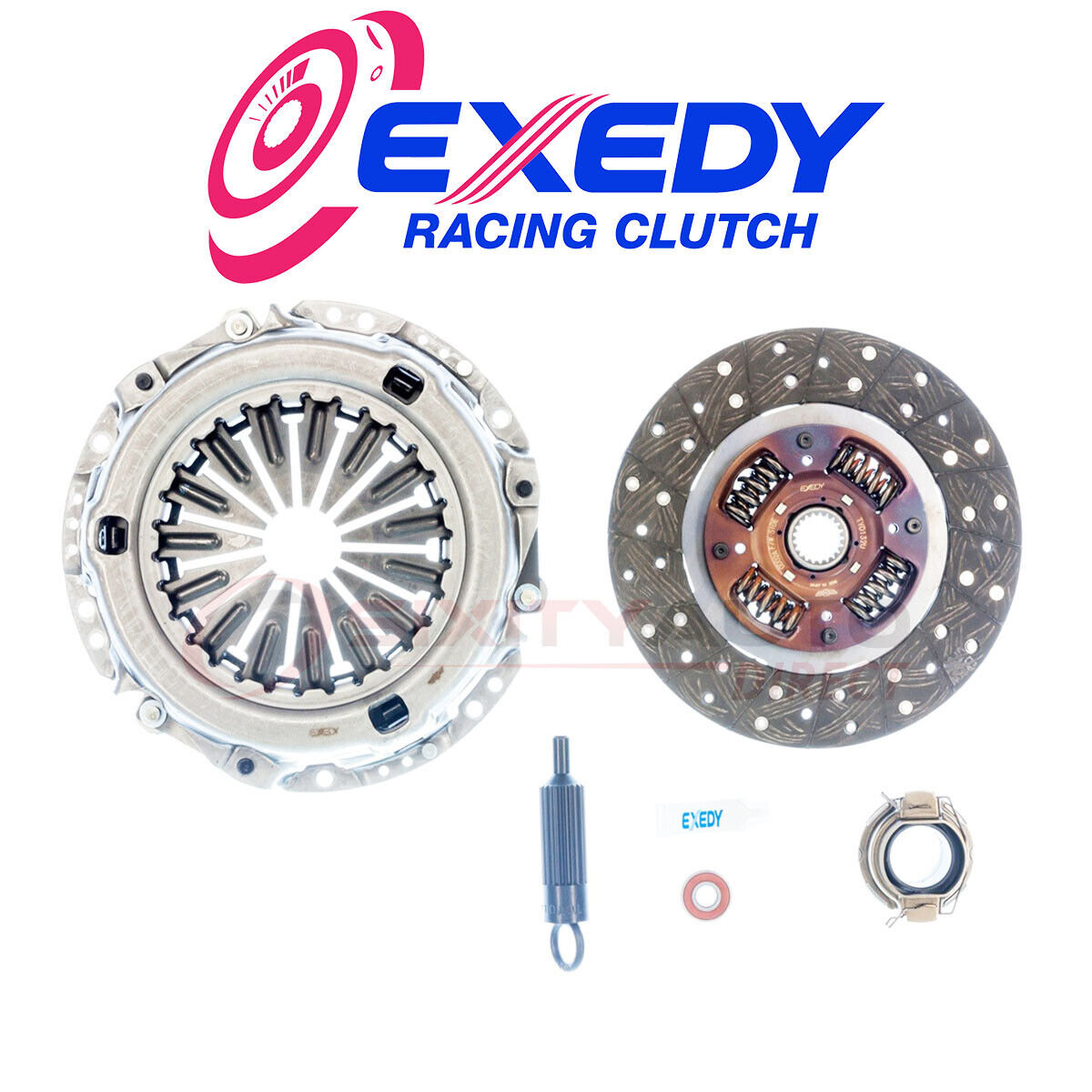

    Just an educated guess, but I think Aisin would be remanufacturing the clutch discs for Toyota to sell. My reasoning is simple. Aisin is/was the original manufacturer of the new OEM Toyota clutch disc and clutch plate/clutch cover that came in my '97 Taco. And both the new Aisin disc and the reman Toyota/Aisin disc have the same type plastic damper spring retainers (below). I would prefer to have metal damper spring retainers instead of plastic. ShowStop recommends the Exedy clutch kit, not the remanufactured Toyota clutch parts, and now I think I see & understand why. It's all about the spring retainers, plastic vs metal. Will keep gathering more info before choosing which clutch kit goes back in my '97 V6 Taco. But bottom line, I think ANY of these 3 clutches would almost certainly be a very good choice for my needs.
    New Aisin CKT-040 clutch kit: with single springs and plastic retainers
    Remanufactured Toyota 31250-35352-84 clutch disc: with single springs and plastic retainers
    Toyota OEM Disc 31250-35352-84 Remanufactured with Plastic Damper Spring retainers.jpg
    New Exedy 16087 clutch kit: this clutch kit appears more HD with dual springs and metal retainers

    I just could not remember what the change was with the Aisin clutch discs.
    I know plastics have improved but I still think the Thermal cycling the difference between plastic and metal if you really cook the clutch is going to be a problem
