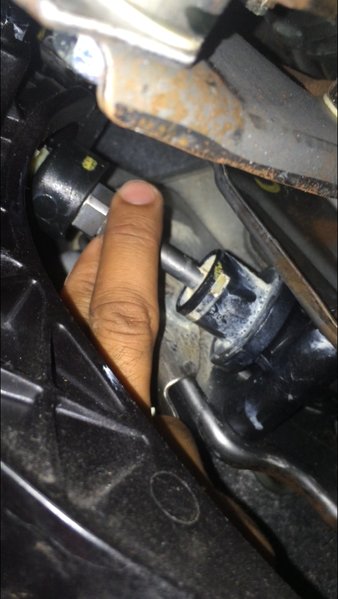

    image.jpg Has anyone experienced having the shaft behind the clutch pedal have lots of play? I have to depress the clutch down to the ground to engage and only about 2-3 inches of clutch to level with.

    Thank you @Jimmyh i was told that I needed to replace the entire clutch master cylinder assembly. If I'm trying to figure out if there is something faulty inside the cylinder. There's is no leaks on the cylinder or the slave, I checked both.

    If no external leaks, it could be a internal leak....
    Check the adjustments before spending money.

    Fluid leaking past the internal piston seal.

    @Taco Pete626 can the clerics be replaced or is it the whole assembly? If so how did you replace it?

    I adjusted the nut and now it seems better but I don't know if this will solve the issue. Especially if the clevis is broken
