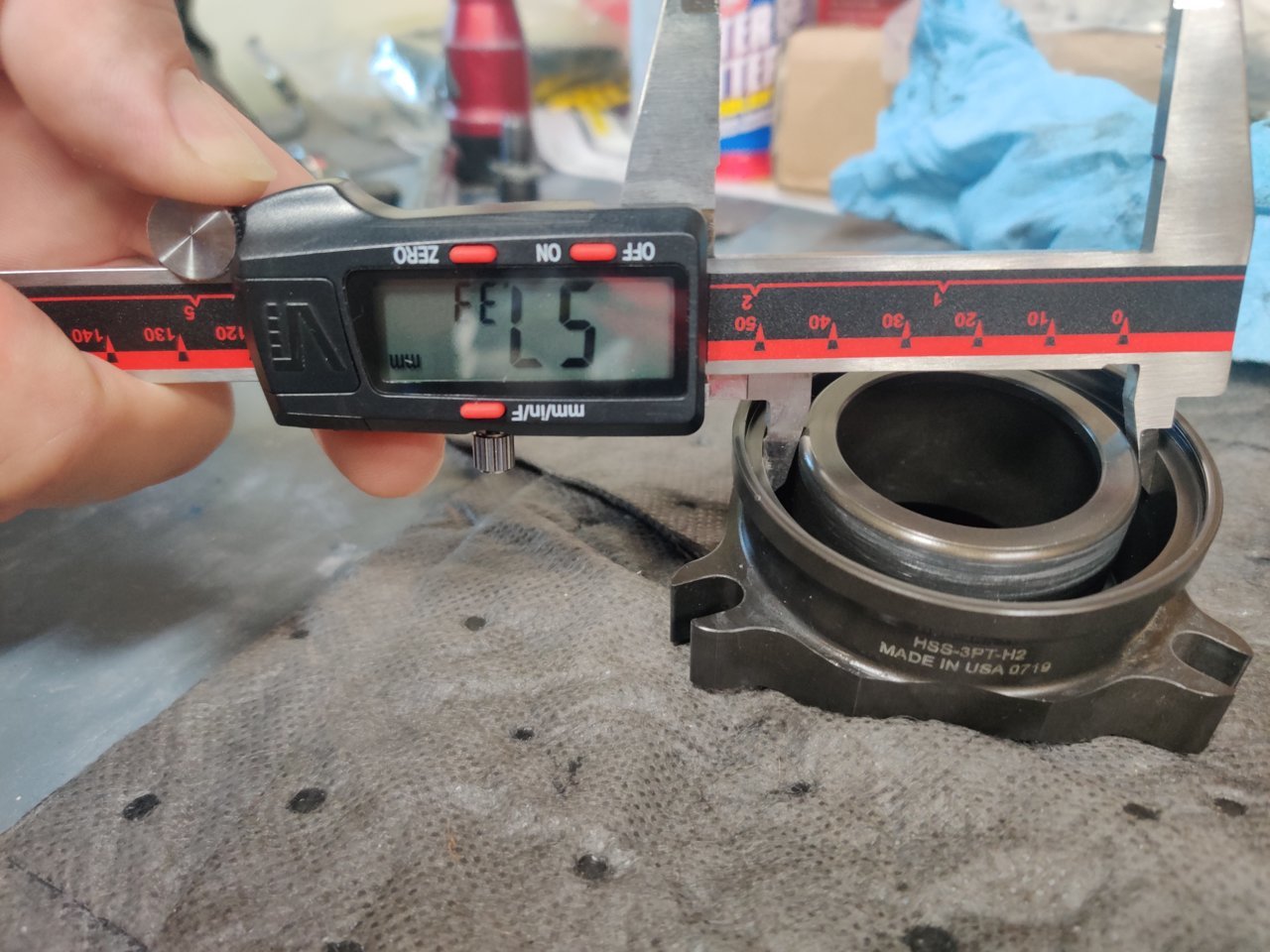

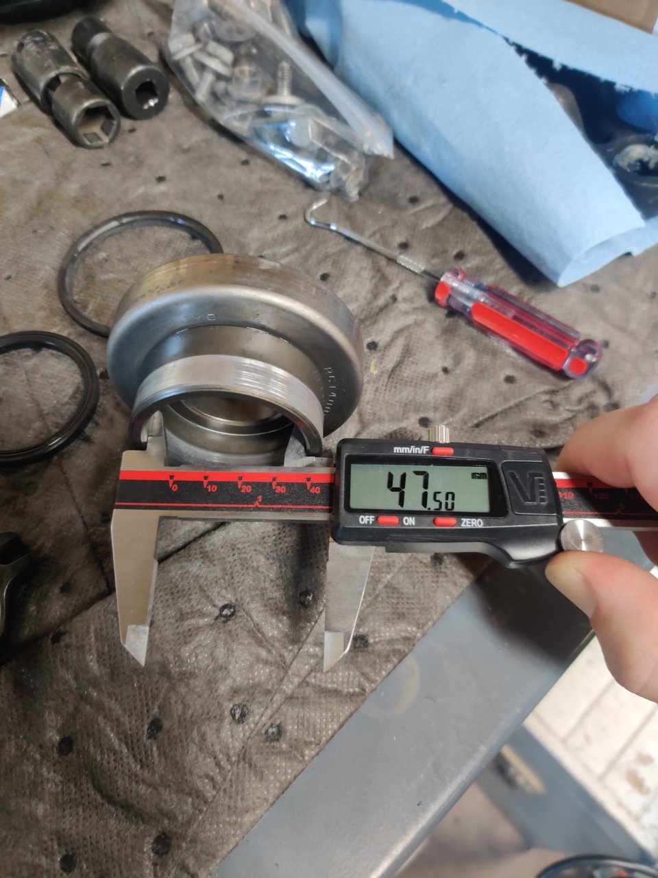

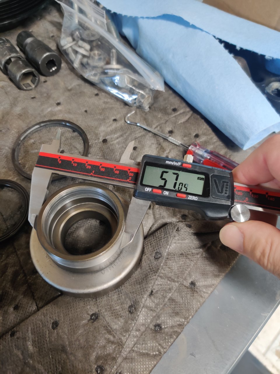

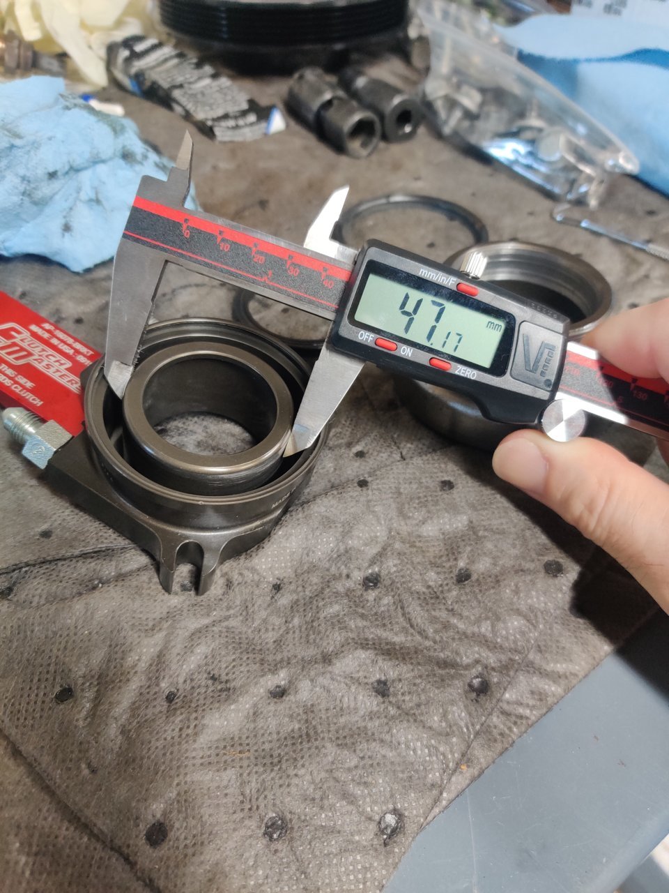

    Today I took the CM unit off the trans wiped it down to take some measurements. There is about .3mm of difference between the piston and the housing. It was consistent from the outside of the piston and the inside of the piston. I'm not an engineer, but I say .3mm is way too much for this application. I think .1mm on the inside and outside of the piston would be plenty.
    Enjoy.

    Using ISO limits for a free-running fit (e.g., H9/d10), the ID should have a clearance of approx. 0.080 to 0.242 mm and the OD should have a clearance of approx. 0.100 to 0.294 mm. You could certainly run a tighter fit, but I wouldn't say these measurements are particularly unusual given the size, that there are rubber seals holding them in place, and that it will also provide axial clearance to allow bearing misalignment.
    Also not sure if you were able to measure past the wear to see what the initial measurements were vs. the worn, but that might have been slightly tighter as well.

    Maybe the seal had swollen, but there was no way that the seal was fitting between the piston and the housing. The way it looked "after failure" was more the seal looked like the "piston" and the piston was moved by the seal.
    Not sure if that makes an sense.
    The seal took up the whole space in the housing. I had to use compressed air to remove the seal from the housing.
