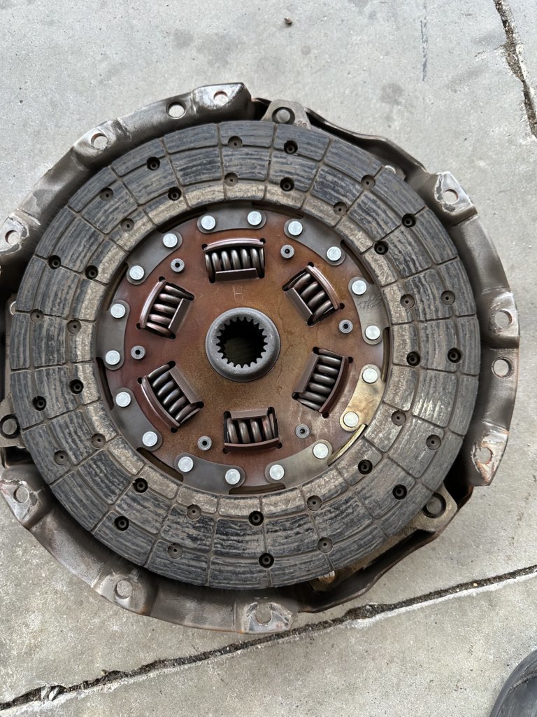

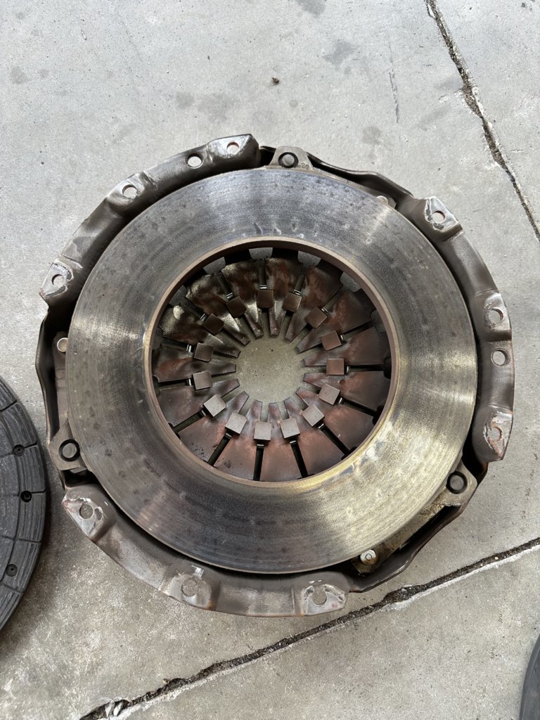

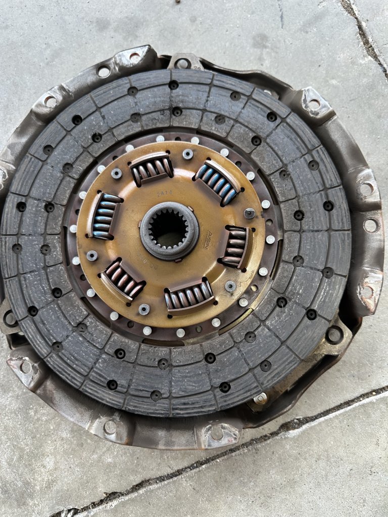

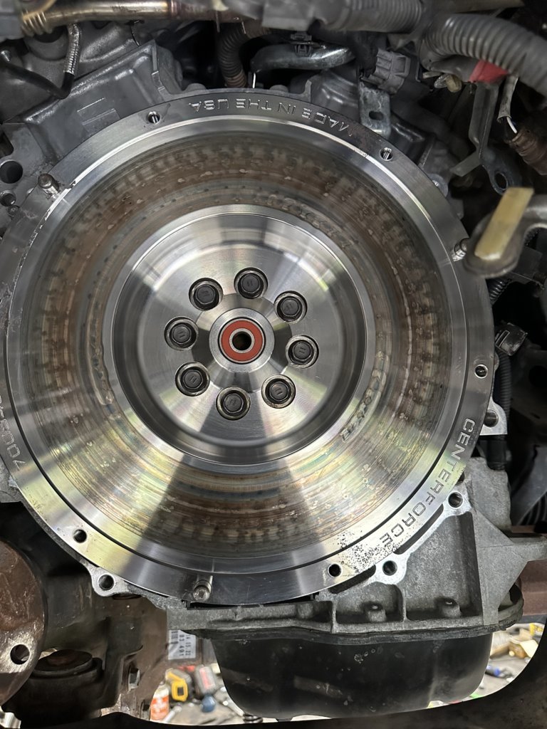

    Here are the pictures of the clutch making that noise. The kit came with everything. I called center force and they said I’d didn’t have a pilot bearing for that setup but they have one in it to help align the clutch disc. First one made it 10k miles. Second made it a few weeks. The kit was completely replaced but the flywheel. Which was taken to a well known matching shop who did a 2 step on it to ensure the camping was the same as it’s stepped where it bolts and where the disc rides.
    Master won’t case that noise.

    Cant really tell orientation from the pic but be CERTAIN youre installing the disc the correct direction,
    It doesnt work correctly either way....
    If that was a new flywheel or resurfaced ion the pic, you def found the problem for whatever reason.....
    That flywheel is beat to fuck, hot spots, heat checked, etc for a fresh install....
    Also the disc is severely worn for a new install...
    Something was causing it to overheat, not disengage completely & drag / overheat, etc...
    Hopefully its behind you at this point...
    Also I would torque everything , flywheel to crank, & pressure plate to flywheel....
    stagger pattern when tightening, always...
    dont ram 1 bolt home at a time on the pressure plate.

    All was installed correctly they have a sticker that says flywheel side on the disc. Everything was torqued to specs and in a few stages in a x pattern all the way around

    Yeah, didnt realize you were a shop doing the work until after I sent the message, appears you know what youre doing...
    That flywheel is beat to fuck or a fresh replacement along with the clutch disc....
