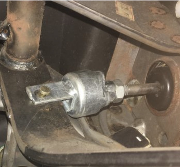

    The clutch on my 99 Tacoma was replaced about a year ago. Right before it needed replacement it was experiencing similar issues where sometimes the clutch doesn't spring back to the normal position getting caught halfway to the floor. Rarely does it stick to the floor. My solution is just to nudge it up with my foot.
    The mechanic I spoke to over the phone mentioned something about master and slave cylinders and quoted me at around $500 for repair. I have no idea what he was talking about. I'm wondering is there anything I can do to help fix this issue? I don't have many repair skills but if there's anything I can try any help would be appreciated.

    Check the clutch mechanism under dash for spring and fork above pedal and at firewall.47162A11-FB3F-45E0-9565-298B3252F351.jpg

    I would start by taking a look at the pedal assembly like Black Dog Lila suggested. There is a torsion spring used in the v6 Tacos that can wear through bushings and cause issues. I replaced mine with a $4 linear spring (P/N 90507-14030) and have been pretty happy with it. The master cylinder provides most of the force for the pedal to return to the top position, however the last couple of inches make use of the spring tension. First step is to determine if your issue is the spring & pedal assembly or the clutch hydraulics.
    I just recently replaced my clutch master and slave cylinder. The Aisin master is $36 and the slave is $22 on Rockauto. It's really not a difficult job, took me around 2 hours. Main tools needed are a metric socket set, a 10mm flare nut wrench, and I would highly recommend a vacuum bleeder. Parts and tools included you should be able to do that job for around $100.
    This new video from Timmy shows how the torsion spring works and also how to remove the master cylinder and bleed the system.

    Definitely check the hydraulics if you ruled out the spring and pedal. Make sure the reservoir is full of clean fluid first, you can also look to see if the slave cylinder is experiencing full throw. Have someone push the pedal and look underneath see if it extends all the way and then release and see if retracts all the way, it works pretty similarly to the rear wheel cylinders. Like others said it is cheap and not too difficult to replace the slave and master. I just replaced my slave cylinder, it took about 45 minutes. Only hard part was getting the hydraulic line off of the slave cylinder there isn't much room. I was able to get to it through the wheel well. The only other thing I could think of is bad pressure plate in the clutch assembly...not sure if it would give the same symptoms though somebody else would have to confirm. I think that's more related to the clutch not disengaging all the way and having a hard time shifting not necessarily pedal issues.
