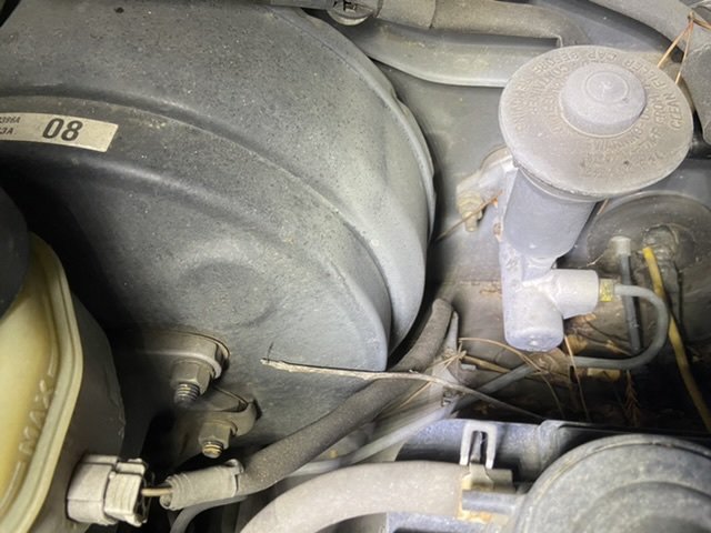

    Looked under the dash, everything looks fine. Nothing appears broken or missing.
    surprised to see a linear spring for the clutch pedal return ( and no sign that it ever had the torsion spring).
    pedal has a little play, about 1/8” at the foot pad (measured off the brake pedal). Looks like the main pedal shaft bushings, no other movement.
    looked like maybe some side to side play where the push rod enters the rear of the master, but no signs of leakage.
    in the engine compartment, everything is tight and dry, no signs of anything broken or loose or leaking. Fluid was full, a little dark so I’ll look at changing it...

    I think I’ll replace the master, the slave and the rubber hose. I have seen brake issues with hoses collapsing internally... but still the intermittent nature with a mechanical system puzzles me a bit...

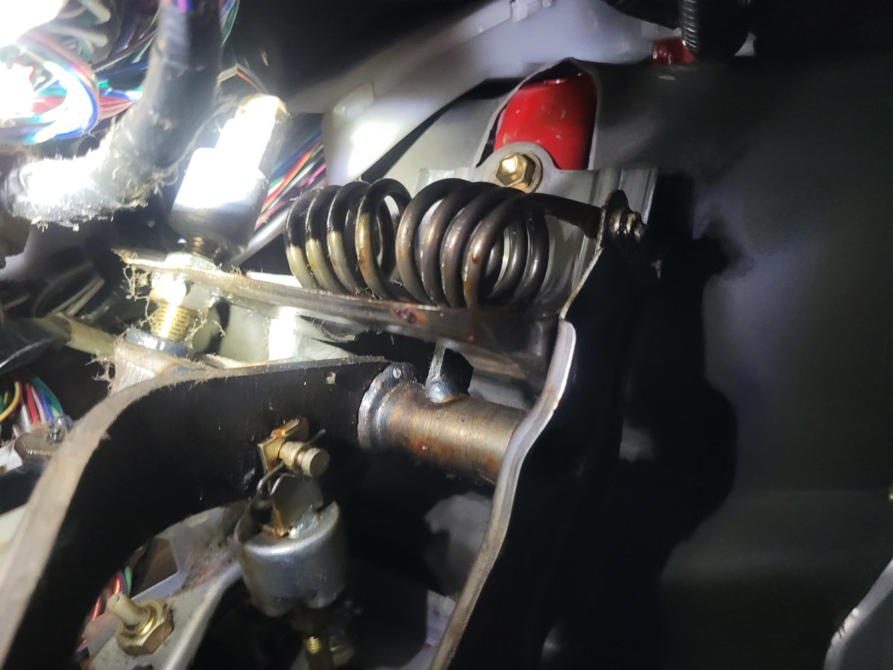

    What does the "Torsion Spring" look like?
    Mine looks like it is "sprung" in the middle of it.
    Is this normal? Do I need a new spring?
    The pedal doesn't always return to the right position. When it is working properly, all the pedal & push rod measurements seem to be correct. I know I need to change the Dot 3 fluid, once I get a turkey baster.
    Just got this truck. 1999 Tacoma SR5, V6, 346k miles.
