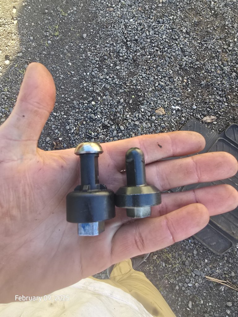

    I'm having the same problem. It appears the clutch pedal clevis is different on the new part from the dealership vs what the truck had originally.

    No problems with my clutch pedal, but just so I know - Is the left one the new version?

    Left = original that was on the truck.
    Right = toyota dealership sold me. Part# 30420-60033
