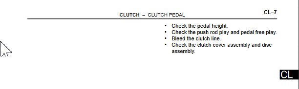

    Pedal Adjustment:

    Thanks for the diagram, looks simple enough.

    From the Tacoma shop service manual.

    Then release the pedal and push gently again with your fingers, there should be two distinct resistance points. The first should occurs at just a small amount of travel of the pedal where only the return spring of the pedal is being felt. Then there is some resistance. We are not talking much here just push it a little and it should be around 1.0 - 5.0 mm measured at the pedal pad. This is the actual free play gap between the back of the clutch pedal and were it just touches the engagement rod of the master cylinder. This is the Push Rod Play addressed in the FSM and it can be adjusted at that point if desired.
    Now that you have established the first point of resistance, keep pushing with your fingers beyond that point and the next resistance point is the Pedal Free Play. This should occur at around 5.0 - 15.0 mm. There is a change in feel at the second point. I know this may be a bit confusing.
