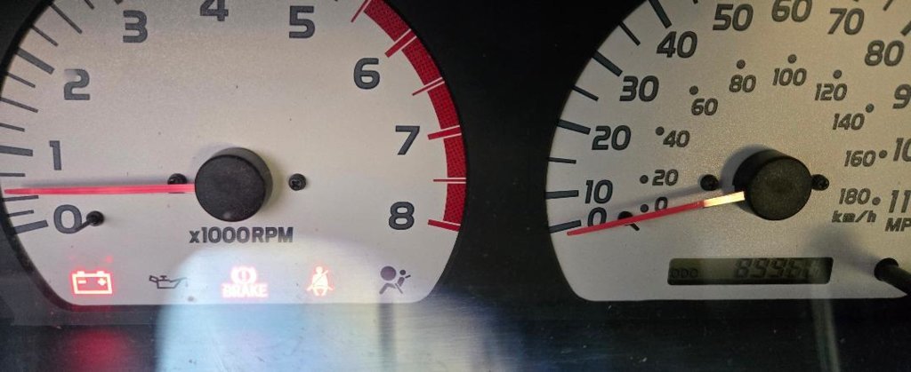

    bpkrules
    bpkrules [OP] Well-Known Member
    Jan 17, 2012
    #70834
    368
    Jon
    Houston
    Tacoma4x4 BATMAN
    ARB Front bumper. Custom rear bumper. ARB snorkel. 883s 90004s. 1 inch daystar body mounts lift. Full skids. Leather seats.
    10 years I've only put on 1,900 miles??!!!
