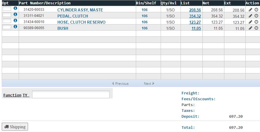

    For Creak/Squeak TSB 0112-19 I have been quoted $950 at the local Toyota dealership. See photo below.
    It seems to have most everything i need though for the repair? Likely no help from toyota, would be all out of pocket for me.
    Also, does anyone have any good online sources for Toyota OEM parts? Might order them myself and have personal mechanic do the work. not sure yet.

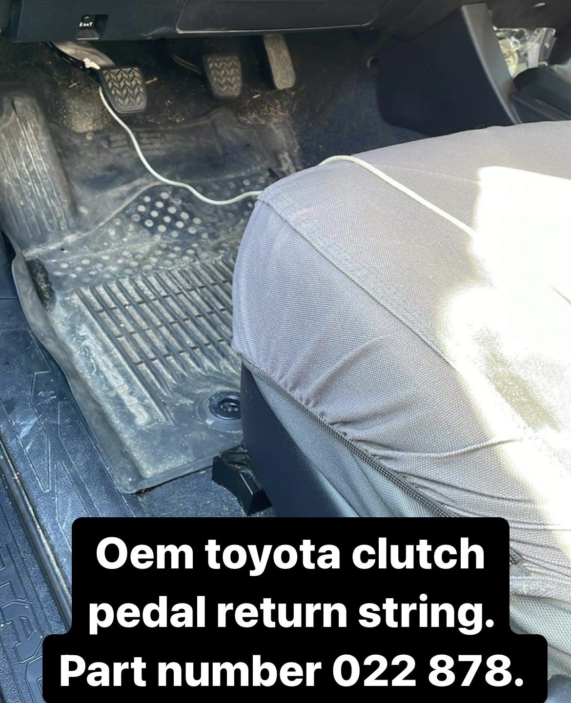

  15. Mar 13, 2024 at 5:40 AM
    jeffmansion
    jeffmansion [OP] Well-Known Member
    Jun 22, 2016
    #190226
    798
    16UTILITY4x4MT2.7
    K&N 63 series CAI, AVS Vent Visors, 16x8 Level 8 MK6 Rims, 285/75/16 MT, Eibach Pro lift, JBA UCAs, Wheelers 3leaf AAL, DV8 skidplate, Westin bedmat, Backrack, swaybar delete, Magnaflow cat-back, 9Drive throttle controller, 2LO Mod, Cali Raised Rock Sliders, Tyger rear bumper, Chinese Body Armor front bumper clone, 10K pound Winch, Smoked headlights, LED Bulbs.
  16. Mar 13, 2024 at 6:19 AM
    #16
    jeffmansion
    Jun 22, 2016
    #190226
    798
    16UTILITY4x4MT2.7
    all joking aside, that string above^ saved my Arse yesterday. Pedal started really acting up on me while driving home. Stuck right to floor. Was using the oem toyota clutch pedal return string for every shift. My truck is now at my mechanics house to be fixed. Skipping the dealerships and the TSB.
    danny15l likes this.
