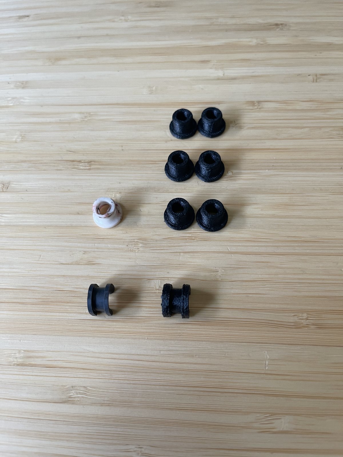

    In Canada, each clips are now $12.60, over $40 with taxes for the 3 of them. Since we got tired of changing them every once in a while and the outrageous price of tiny clips.... well we spent 10x that on R&D to come up with some Low friction, long lasting Carbon Fiber reinforced Nylon bushings.... :rofl: Anyway, we have a few left if anyone is interested of testing them.
    [OLD ON THE LEFT] | [NEW ON THE RIGHT]
    Dalandser[OP] likes this.
