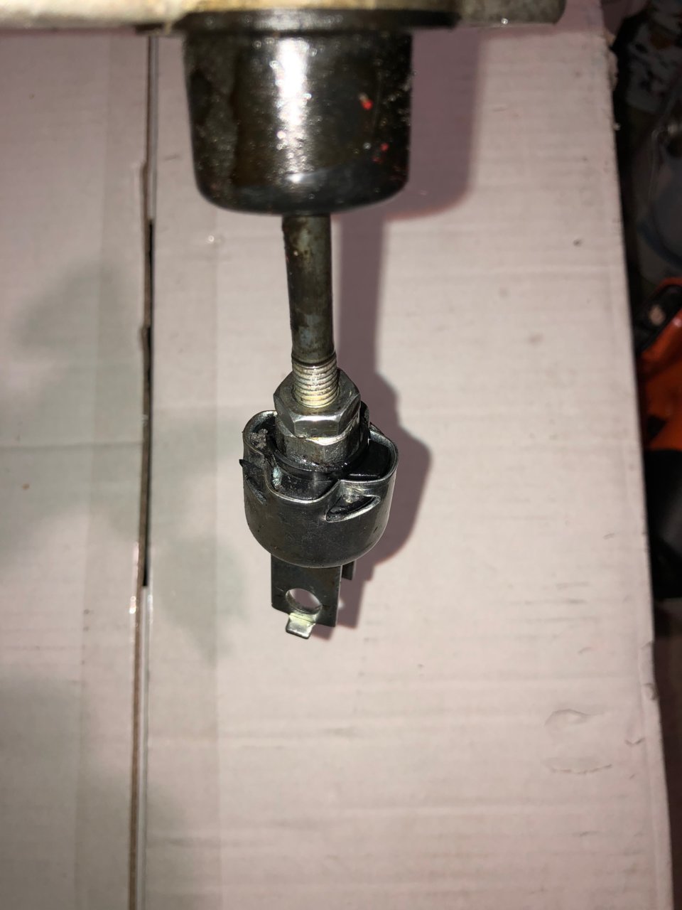

    I wouldn't even think about it and just replace both the Clutch Master cylinder and the slave cylinder. You can get both parts from Rock Auto for less than $60 AISIN brand made in Japan OEM. Just starting going though my son's 2000 Tacoma we just bought with 225k miles and replaced both today. It had a really deep clutch pedal that barely engaged now like brand new. The plastic around rod fitting into the case actually compromised giving additional play and no travel. The black crap in your fluid is most likely degraded seal material.
