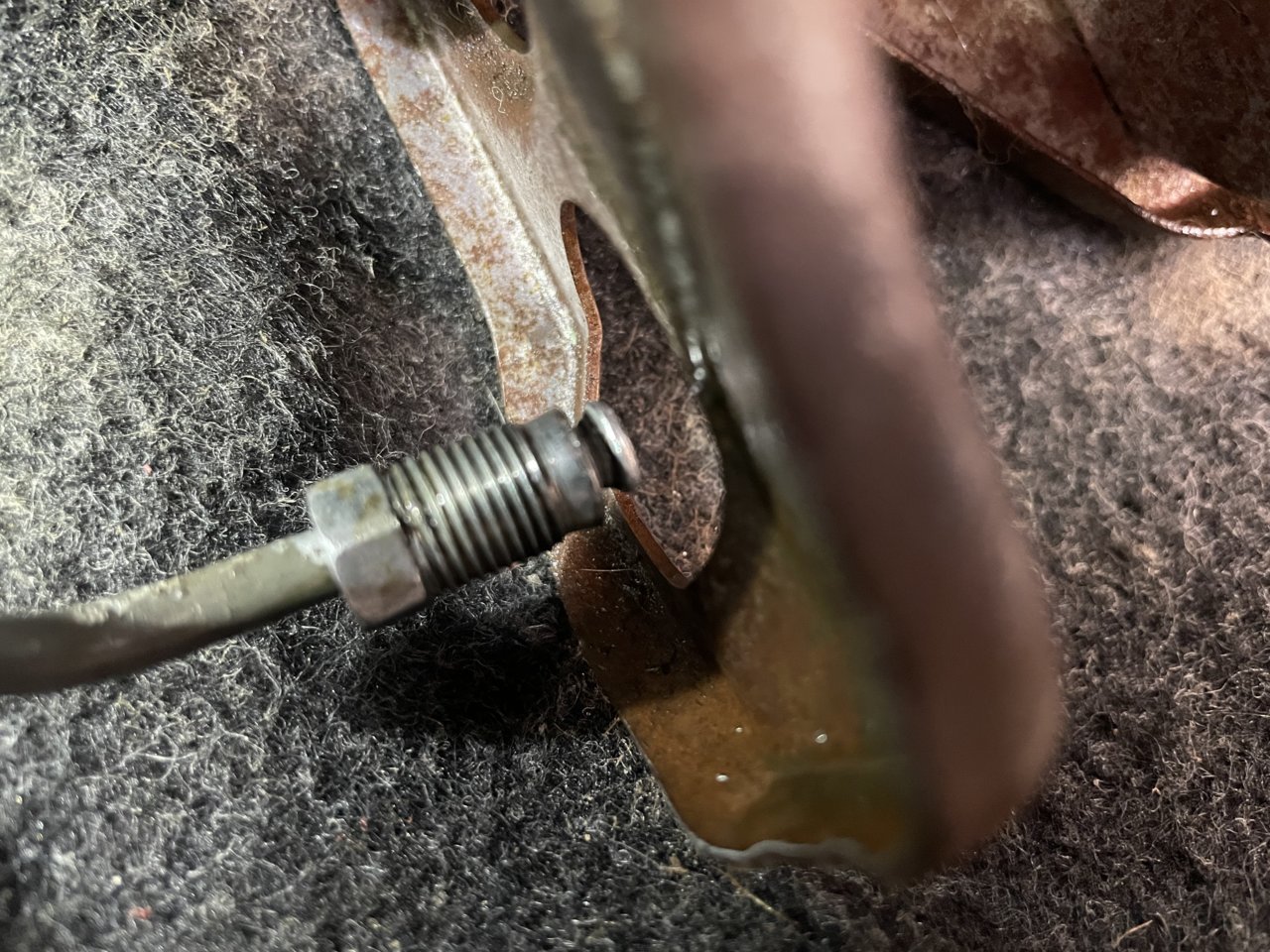

    Ok. For those who already did it. I got my old clutch master cylinder out but been fighting to get the new one in. Replacing because it was leaking. I think one I get the big black hose on, I should be ok from there

    If the fitting is flared out like this, you’ll never get it started. The proper fix is to buy a new hard line from Toyota.

    I've had that happen before. At the time, it was my only daily driver. So I spent a great deal of time with a file to flattern out the mushrooming and got it to seal.

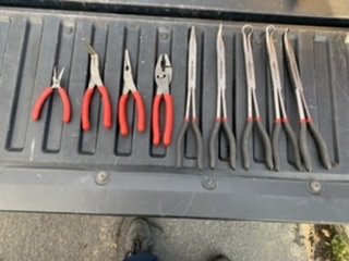

    For todays task, I figured since I first loosened the flare nut at the bottom, then unbolted the clutch master cylinder, then disconnected the big black hose up top..., I'd go in reverse order to reassemble. The clutch start switch was in the way of one of the bolts so it had to come out. I spent a good hout trying to get the black hose back on. Finally tried getting the 2 bolts back in first, then with more cussing & cursing Toyota, I managed to get the hose on, then the spring clamp in place. What seemed to help was to position the spring clamp back just far enough so the hose could be pushed all the way on to the barb. I was able to grab the clamp and push on it to assist getting the hose on. Having the clamp positioned so it could be grabbed, opened, and put into its correct place would also be helpful, I didn't do that so I had to move it first. I used my angled pliers to open and move it to the right where it needs to be. The rest of the install was gravy. 12mm socket for the 2 bolts, 10mm flare nut wrench for the hydraulic line. I did pull the plastic trim off to the left of the clutch pedal. Not that it helped much. I did notice the master cylinder coming out was plastic, the new one cast aluminum or pot metal. The fitting for the black hose was slightly cocked upwards compared to the old one went straight out to the left. Since I had it out, I tested the clutch start switch, it failed so I'll need to replace it.
    Of the multiple pliers I pulled out, the 2 on the left were the most helpful.

    I meant the 2 on the left of the picture

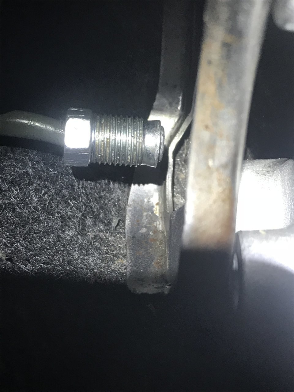

  13. Sep 4, 2021 at 8:14 AM
    Appleman
    Appleman Member
    Sep 3, 2021
    #376123
    15
    2008 2.7L Tacoma
    This is how my fitting is looking. Replacing the line looks like a pain, guess I’ll try filing it down
