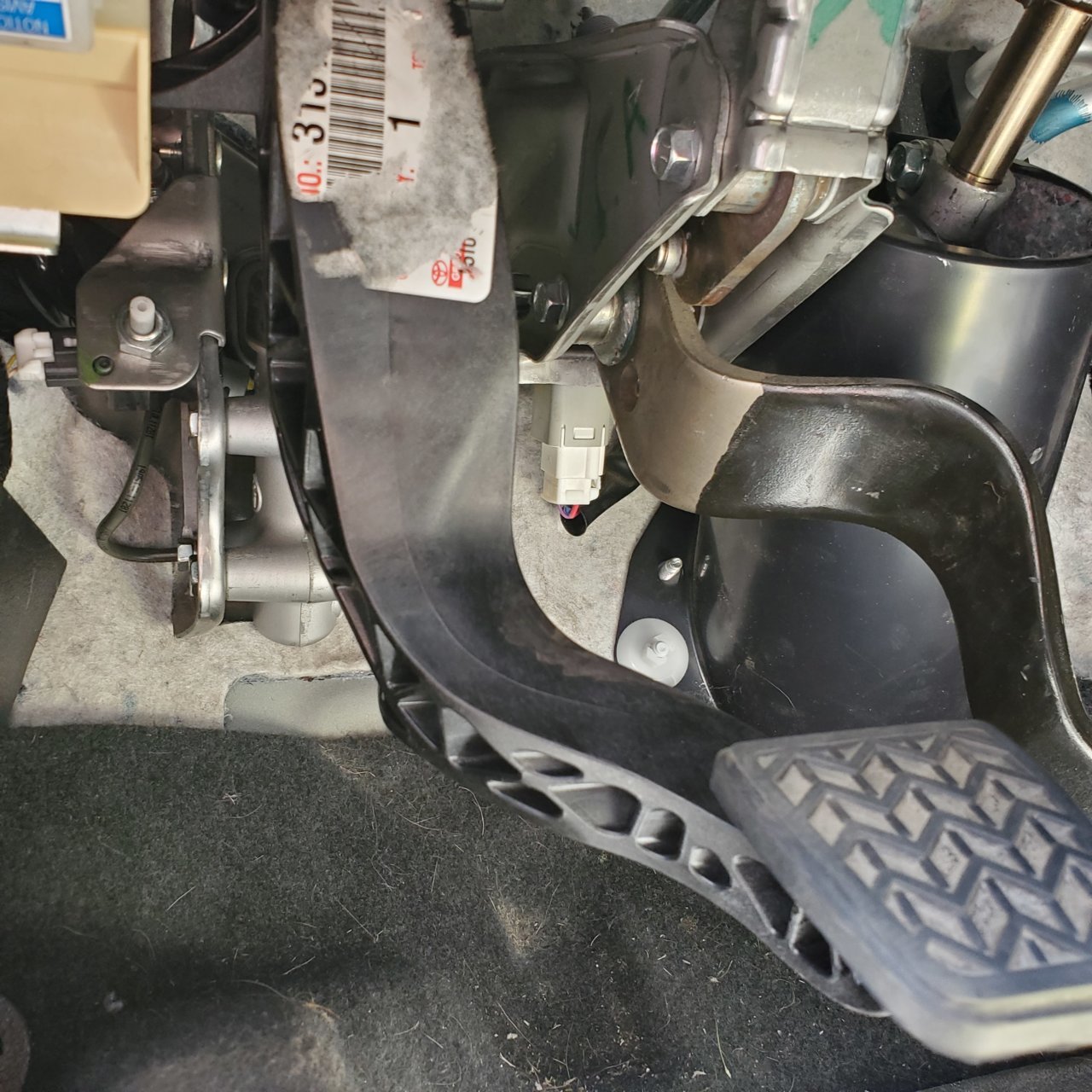

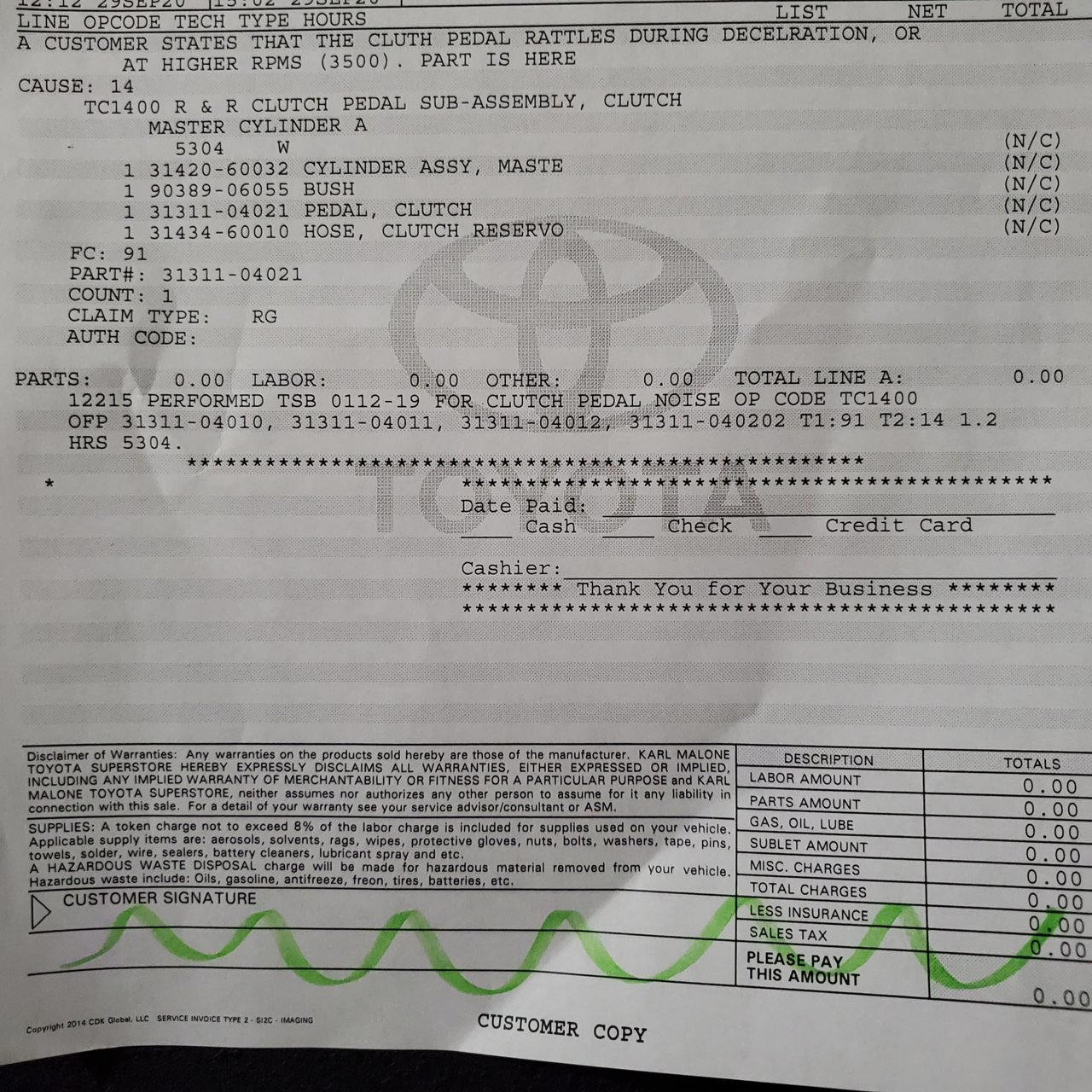

  11. Sep 30, 2020 at 3:53 PM
    #31
    sivill
    sivill [OP] Well-Known Member
    Dec 2, 2019
    #312346
    86
    Got the truck back today. A lot more was fixed than the guy said over the phone but its what i expect to be fixed.
    Forgot to take a picture of the invoice but I will once i have the chance. So far ut feels great! Like a new truck but i have only gone 1 mile at most.
    20200930_145227.jpg 20200930_145219.jpg 20200930_145227.jpg 20200930_145219.jpg
    Rick111 and su.b.rat like this.
  12. Sep 30, 2020 at 3:59 PM
    #32
    Myles G
    Myles G Well-Known Member
    Sep 24, 2018
    #267233
    599
    Myles
    was this for clutch squeak or clutch rattle
    also were you charged ?
  13. Sep 30, 2020 at 4:02 PM
    #33
    su.b.rat
    su.b.rat broken truck
    Jul 30, 2016
    #193316
    9,869
    congrats! wow they actually fixed you up. keep your dealer! lol
    sivill[QUOTED][OP] likes this.

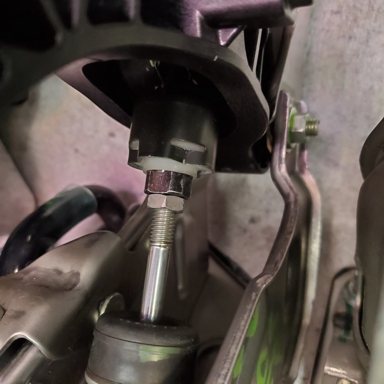

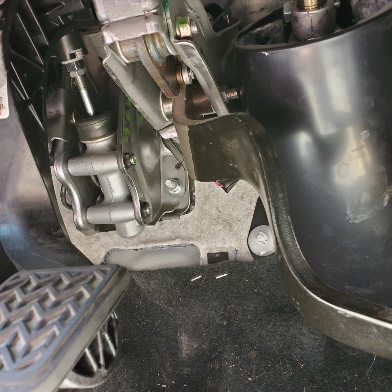

  15. Sep 30, 2020 at 7:23 PM
    #35
    Myles G
    Sep 24, 2018
    #267233
    599
    Myles
    Is this the push rod
  16. Sep 30, 2020 at 9:24 PM
    #36
    sivill
    Dec 2, 2019
    #312346
    86
    Yes it is. My last one was loose. After the fix its tight and I was unable to wiggle it.
  17. Sep 30, 2020 at 9:27 PM
    #37
    sivill
    Dec 2, 2019
    #312346
    86
    I did the same and the truck clutch engagement was all over the place and when I dropped off the truck it was grabbing at the very top. Something was very off. If anyone is interested I will get better pictures of the replaced parts and I still plan to add a picture of the warranty invoice.
  18. Sep 30, 2020 at 9:31 PM
    #38
    sivill
    Dec 2, 2019
    #312346
    86
    No kidding. I was shocked at how fast they diagnosed the issue then the truck was fixed 3 hours after i dropped it off. From what I can tell the work looks good everything tight. Fingers crossed. The information you provided me allowed me to explain my issue in detail and used correct terminology.
    I still plan to upgrade to an all metal set up. If it failed once under 10k miles the possibly of it happening again is high.
    su.b.rat[QUOTED] likes this.
  19. Sep 30, 2020 at 9:32 PM
    #39
    sivill
    Dec 2, 2019
    #312346
    86
    This was fixed under warranty. I had the squeak and clutch rattle. But it was repaired due to the rattle.
  20. Sep 30, 2020 at 11:46 PM
    #40
    sivill
    Dec 2, 2019
    #312346
    86
    Looks like it was fix under a TSB
    Myles G likes this.
