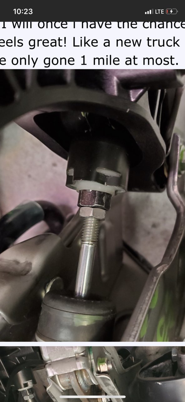

    If you adjust the push rod yourself use a 12mm for the jam nut and a 13mm for one you are jamming against. Loosen the 12mm and spin the rod to make it longer. You want a little bit of play, like 2mm or so. Don’t make the rod so tight that it doesn’t move a little. Too tight will potentially cause your clutch not to fully engage and slip.

    I will give this a go. After my drive home the engagement still didn't feel 100% right a little high still but amazing compared to what it was.
    If i had to give my thoughts the clutch master failed. It didn't have the spring it has now. It felt slow and lazy. Who knows.

    The other clutch adjustment is the pedal height. Maybe that is what feels high. I left mine at the factory setting. If you do adjust pedal height you will also need to adjust the push rod.

    I'm having this same issue. I have 2017 with the stock clutch with a tad under 30,000 miles. Here's what my push rod is doing. This doesn't appear right and I get the same vibration rattling. I'm taking my truck in for routine service in the next few weeks so I'll have to tell them about this. I hope they don't try to charge me... there's no way this push rod should come loose with so few miles.
    https://youtu.be/RLpn42fCyzs

    Mi
    mine does that too. 2017 stock clutch. I guess it’s normal.

    Mine does this too but not quite as bad, also the pedal squeaks like crazy. The dealership says that they will replace the clutch pedal assembly and master cylinder under warranty, I’m currently waiting for the parts to arrive.

    Getting all the parts in took longer than I expected, but Toyota replaced everything under warranty and the clutch petal no longer makes any noise.
