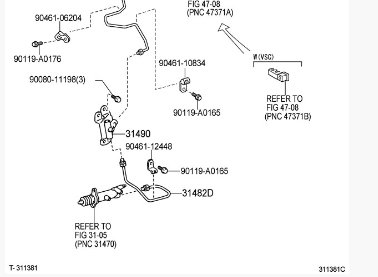

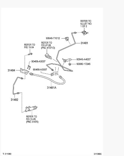

    Hi all. I have an '07 V6, 6MT Tacoma and the tube going into the slave cylinder blew out on me yesterday. I thought it'd be an easy fix to replace the cylinder and the tube but I can't find the correct part number for the tube anywhere. Every site that I think I've found it on tells me that's incompatible with my truck. Is there a clickable electronic parts catalog available online for these trucks anywhere? (It's my dad's truck, I'm new to working on it, but I know for example, old Supra parts catalogs are available on a couple different sites where I can just click down until I find the right part number)
    It's the tube shown in the picture, can anyone point me in the right direction?
    Thanks!

    Holy shit! was that on the Titanic? The 31482 ?
    OR 31482D

    Yep, it's 31482 in those pics, that's as far as I can get because, apparently, there are a whole ton of 31482 "clutch release tubes" from Toyota but they're all different. I'm really hoping I don't have to 1. make my own or 2. go into a dealership..ugh

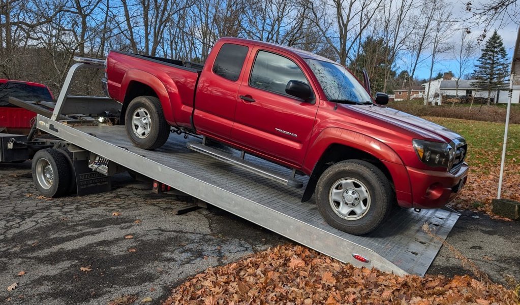

    For what it's worth, most of the truck doesn't look as bad as the slave cylinder, a pic for proof :)
