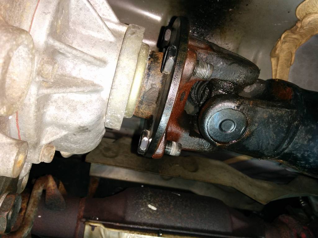

    I'm mostly following these instructions: I'm having trouble with the drive shaft. I've broken the nuts loose (drive shaft, not mine) but there are bolts there that refuse to yield. They aren't weld to/part of the flange on the t-case, are they? It sure looks like they need to come out to get the drive shaft out of the way.
    Further back, the drive shaft appears to have a joint (carrier bearing?). Do I need to . . . . do something here to get the drive shaft out of the way?

    pictures would be a big help.
    It makes things easier to drop the whole drive shaft. 4 bolts at the t-case flange, 2 bolts holding the carrier bearing in and 4 bolts at the rear axle flange.

    Here's a picture. Meanwhile, I'll go see about the other bolts you mentioned. I had intended to just adjust the drive shaft, but if the whole thing needs to come down then that's what I'll do.

    Yeah, you'll want to drop the whole drive shaft. Start with the rear axle flange and work forward. This will let you slide the drive shaft off the t-case flange.
    You'll want the room anyways for when you slide the transmission back.

    when I did my drive shaft on my 95, those bolts you show going through the flange are knurled like on the lug nut studs that go on the wheels, not meant to turn,

    Bolts are just corroded in, put a nut on and smack with hammer.

    they are pressed in as pulldo noted.
    No reason to take them out unless they get damaged.
    OP already got it removed. Just have to break at the carrier bearing then slide the front section off the bolts.

    I think you need to go back and check your facts before recommending to someone the improper way to do something. Those bolts, as mentioned, are press-fit like a wheel stud. This is the same on ALL of the rear driveshaft connections for the Tacoma since 1995. Both first AND second generation.

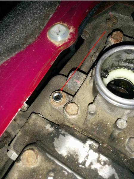

    I got one of the top two off, but the one above the slave cylinder . . . OMG. I'd hate to pay someone $1000 just because of one bolt, but that thing is really hard to get to.
    JudoJohn, I don't see anything from the transmission bolted in any way to the exhaust system, the starter is on the passenger side, and the only thing I see threading in from the engine side is the plate that TomTom is talking about. Are you sure you're referring to a 1st gen truck (2003)?

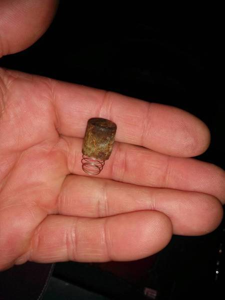

    In the process of trying to get this last one out I broke something, too. This thing:
    Which broke off of here:
    What the hell is it and do I have all the parts (metal cap and a spring)?

    looks like a vent cap?

    it is a vent cap.

    breather valve. It can wait to be fixed.
    I don't recall having to use any universal joints on the ratchet when getting to the top two bell housing bolts. At most, I used a couple long 3/8" drive extensions.
    If you've taken out the transmission crossmember, you may be able to lower the transmission (tilting the engine) to get better access to them.
    Have you looked at getting at the top driver side one from either the engine bay or from below, by the clutch hydraulics? I seem to recall having enough room by the clutch hydraulics to torque it back up when I reinstalled.
