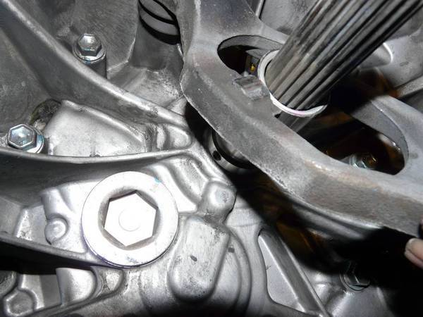

    there was 11 bolts around the bell house to remove.

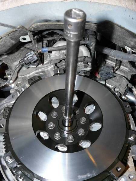

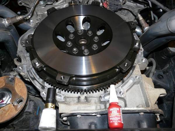

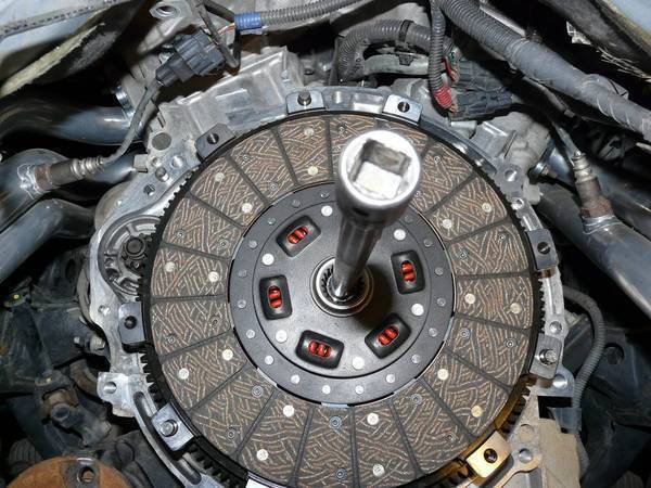

    torqued flywheel down evenly @ 83 newton meters. used alignment tool (17mm husky w/ext.)

    this brass looking side i put towards the flywheel side.

    aligned clutch disk (notice clutch disk side is different than flywheel side)

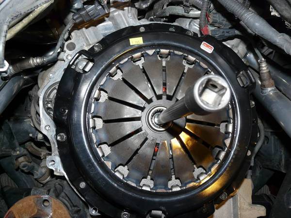

    torqued pressure plate on evenly.

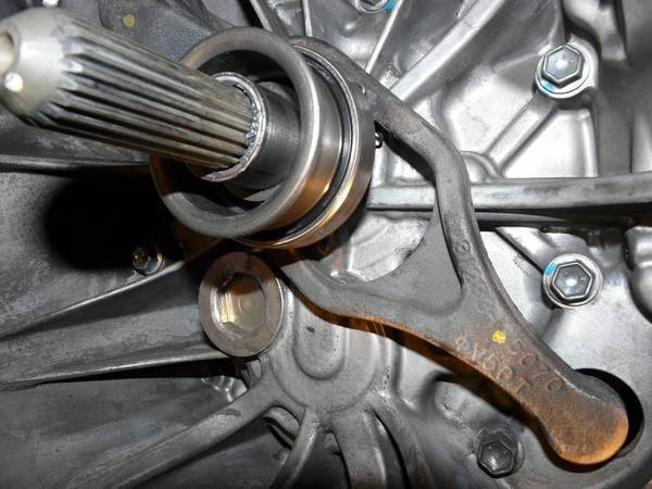

    removed stock throwout bearing. tapped sleeve on w/flat head chizzel. tighten w/allan wrench.

    put new throw out bearing provided by urd.

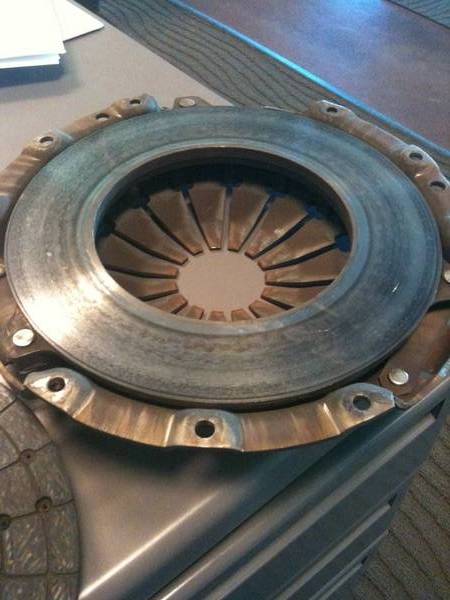

    Oh and come to find out it is was the pressure plate assembly that broke and Toyota wouldn't pay for it

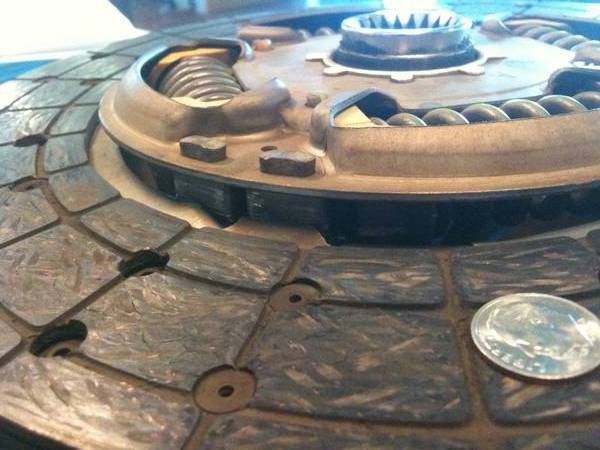

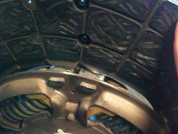

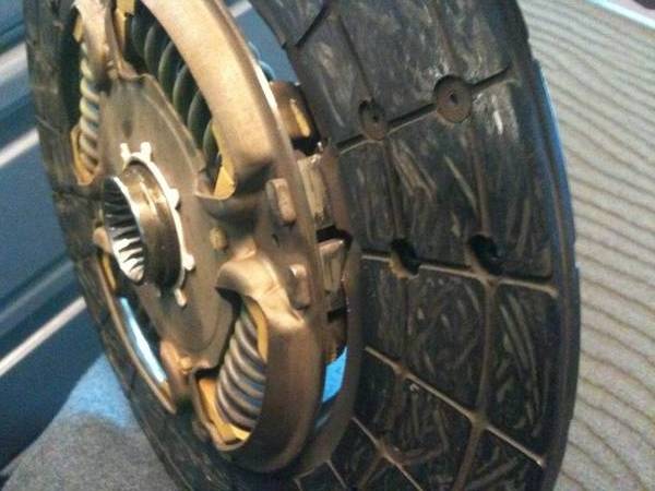

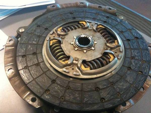

    Yea I just got my clutch and truck back and I will post some pics the wouldn't cover my clutch which under the 5yr 60k mile warranty should be covered unless they feel its ware and tare item or from abuse and it I believe was neither. The enire clutch pad was sheared off from the center peice of the clutch pad and they said it's a abuse item which I wasn't racing nor off road at the time. I will post pics please stand by
  17. Nov 20, 2010 at 2:09 PM
    #37
    4x4Tacoma
    4x4Tacoma Well-Known Member
    Mar 1, 2010
    #32342
    89
    Ben
    Fresno, ca.
    08' Tacoma, RR lock 295/75/16 MT 3" level kit
    3" leveling kit by Hell Bent Steel, 295/75/16R mud tires
    [​IMG]my old clutch pad as u can see very poorly made and can not handle the torque in which the engine has provided be carefull if ever need to paas a car as i was doing an i down shifted and this happened and as for now the dealership wont pay for it or warranty but i have opened a claim and will keep you all up to date
