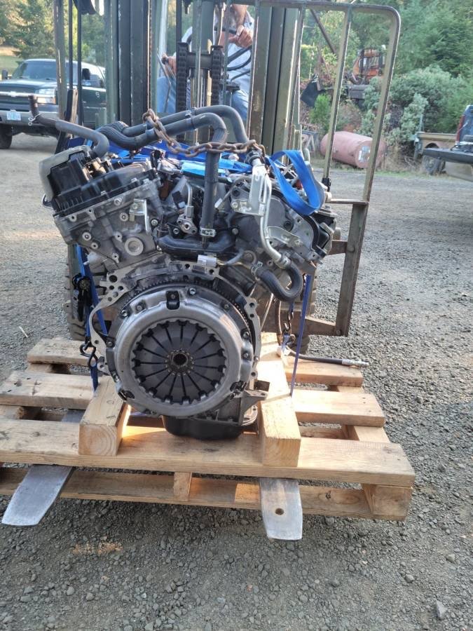

    Here’s a picture of the back of the engine, the wonky plastic coolant crossover is well worth replacing while you have the tranny out.

    MOST defiantly, a must check. If it is the seeping the pink corrosion will be in you face with the tranny off.
