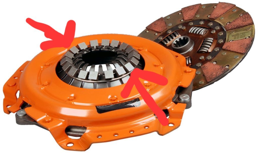

    I watched the youtube vid on the centerforce clutch and apparently their pressure plate has some technology that increases the amount of pressure being applied to the clutch pad against the flywheel but they didn't go super in-depth about it.
    The guy at phoenix told me they use an OE pressure plate and they just manufacture the clutch pads as part of their kits. Didn't ask about the TOB they include, which I regret.

    Centerforce uses similar to stock springs and these weights on the release fingers to increase clamping pressure as rpm increases. This combination allows for a stock feel at low rpms and improved clamping forces at higher RPM.
    I used one in my Mustang that I drag raced, years ago. It was a used one I scavenged from a wreck at an autowrecker. It worked fantastic. Made my cheater slicks bark when I power shifted at high RPM. Even into 4th gear.
