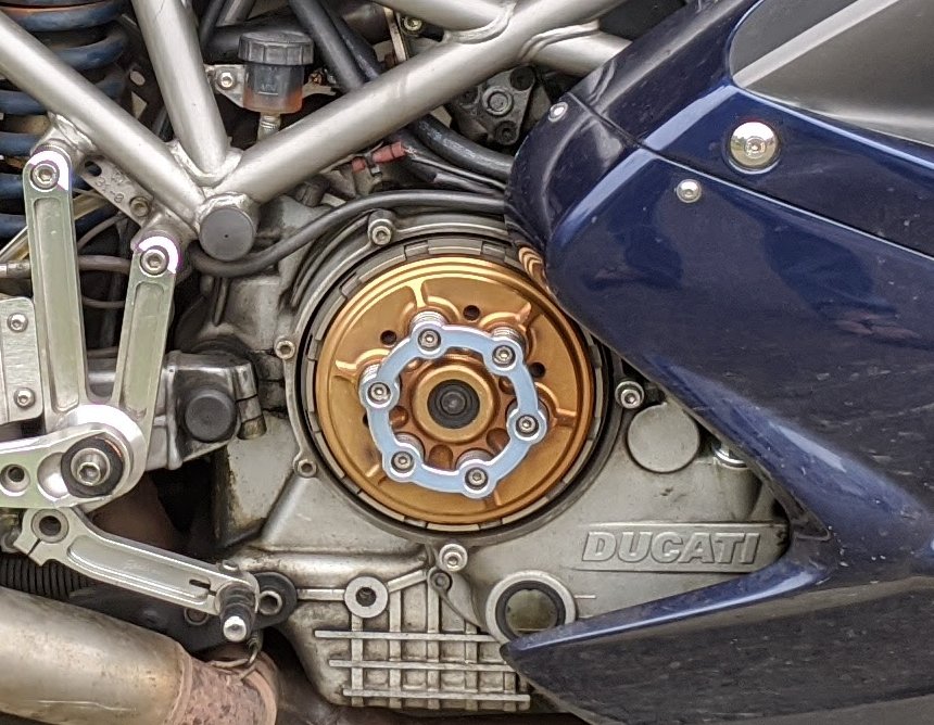

    Folks would play that game with PPs and springs on dry clutch Ducatis. Some would run three or four springs instead of six. Thankfully, mine worked great with just a new, matched set of six. What an easy machine to do clutch work on. Hahaha!
    That PP started out black, but it was a bad anodize. The copper color is likely offensive to the purists. :rofl:
