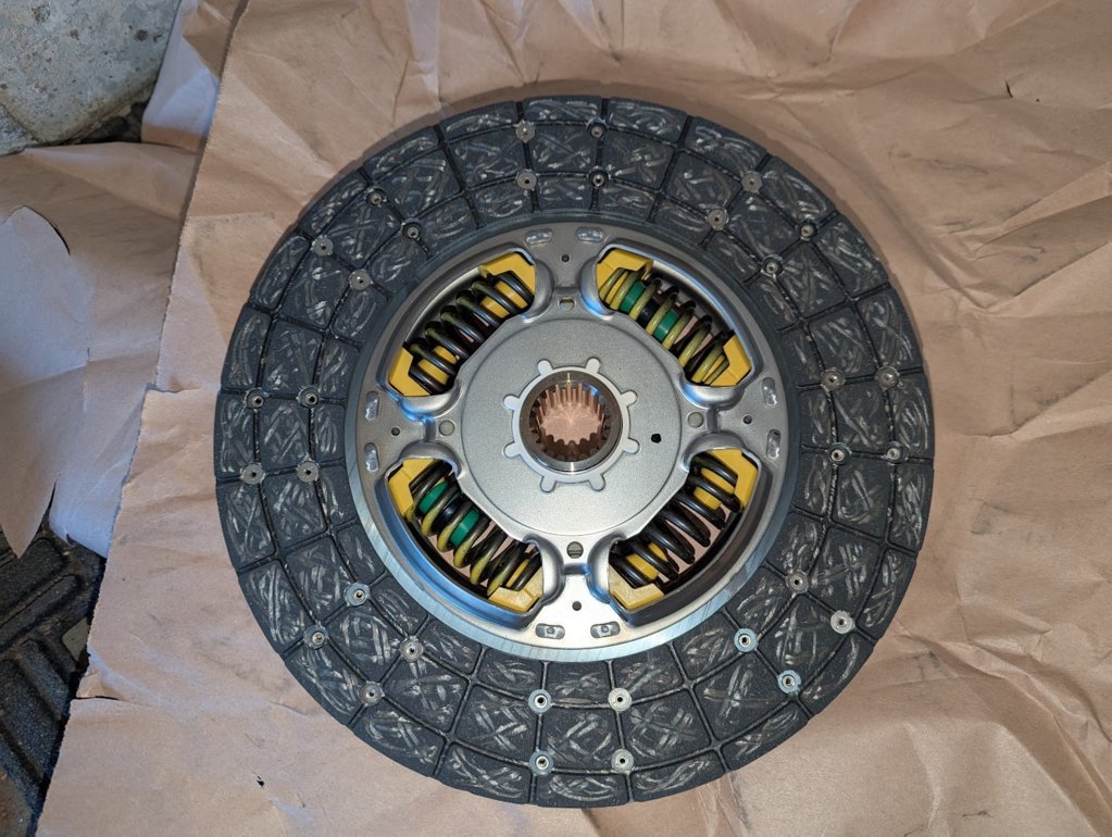

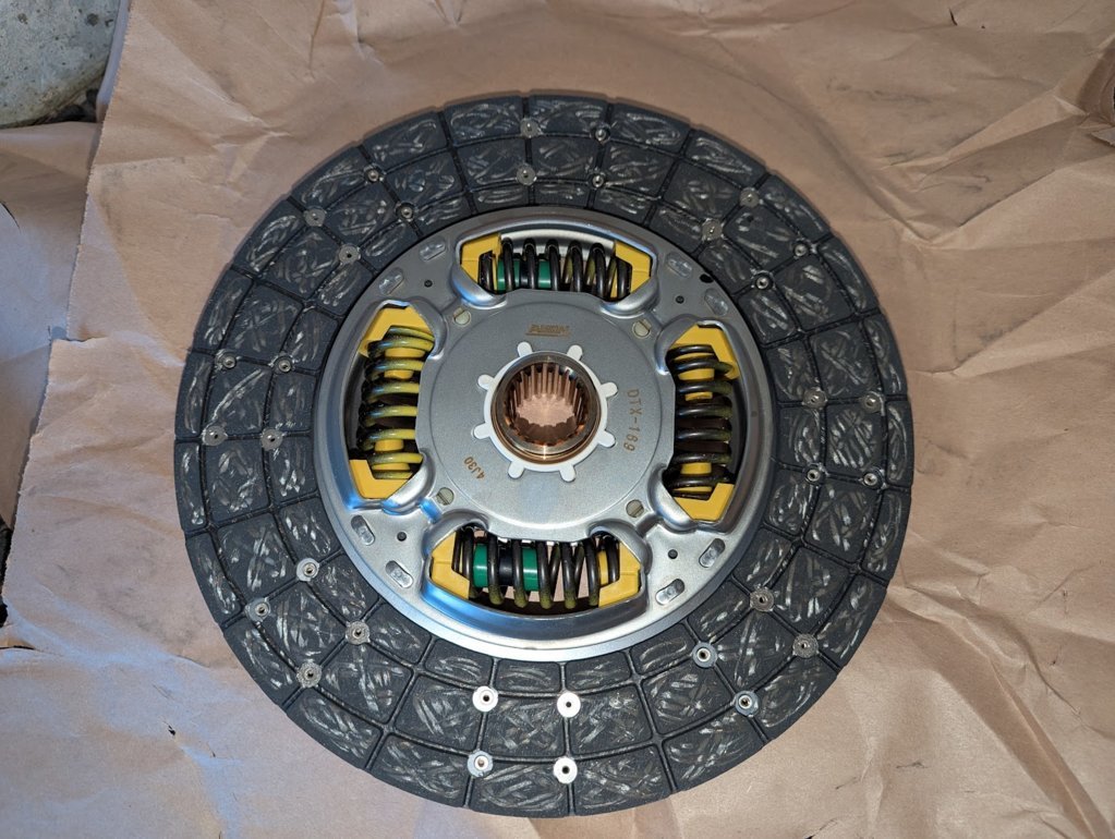

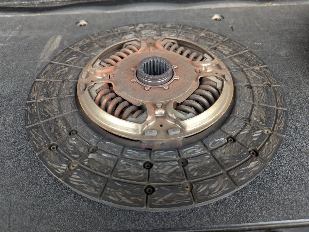

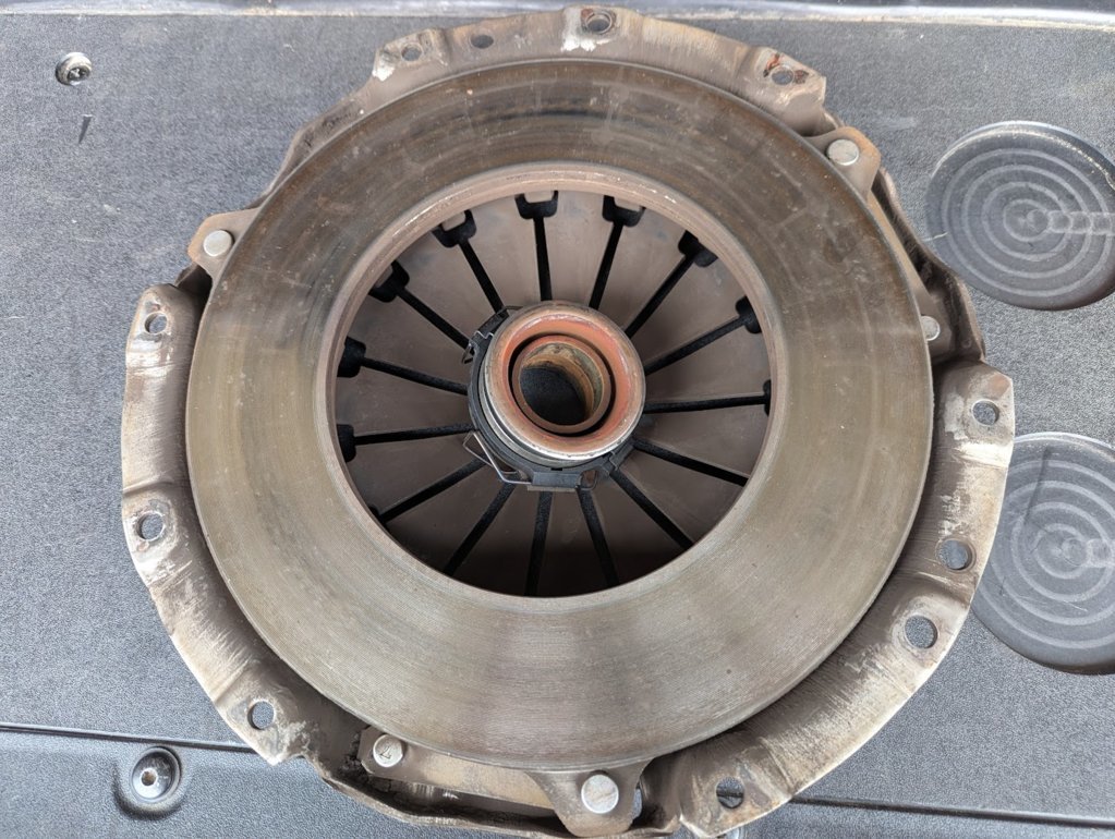

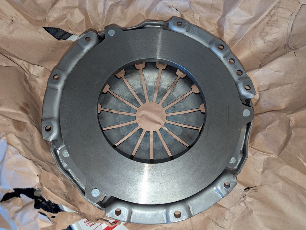

    I just installed this last weekend:
    https://www.amazon.com/dp/B0CMX9TVGW
    Note that this kit came in a single Flat Rate box with no MFG packaging. I was not too thrilled about that, but for the price and feel of things right now, I'm pretty happy.
    It was more to solve my TOB nightmare. No obvious wear on the clutch coming out. There were one or two loose PP bolts though.
    BTW, that TOB was bought from a dealer. I installed it in mid-August, 2023 about 15,000mi ago. :annoyed:
