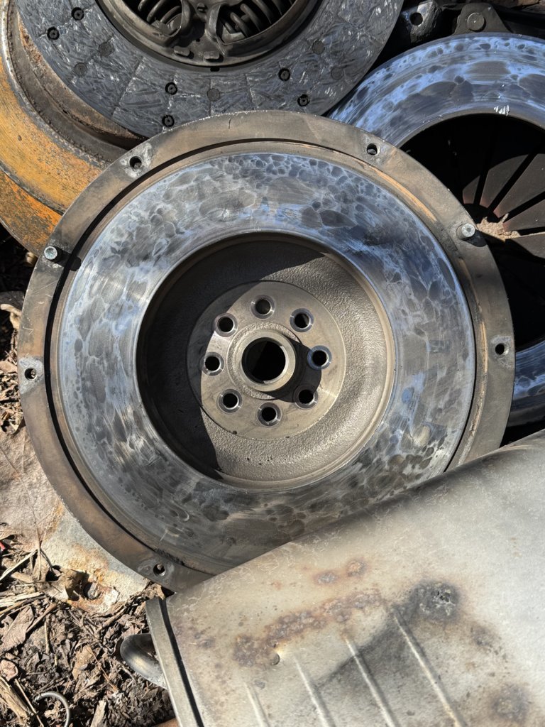

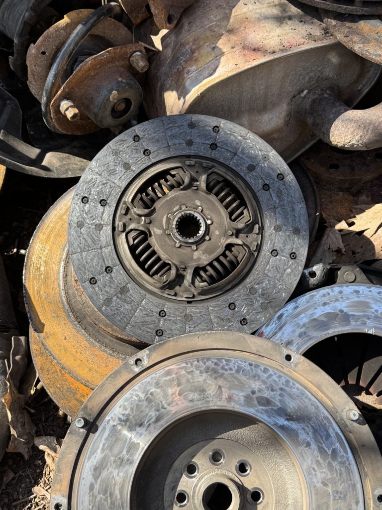

    Put in the Centerforce dual friction kit with flywheel today. Oh. My. God. Granted I’m coming off of a totally smoked factory clutch with 176,000 miles. Posting pictures of the parts I removed. On a scale of one to 10 how bad do you guys think they are?

    That clutch is toast.
