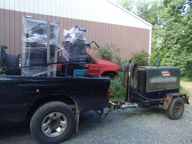

    Being Honest it comes down to your driving Habits I have seen brand New Clutches ruined by the Clueless in 20 miles..
    Any of the name brand should work I have Aisin in one Luk in another The Marlin Crawler 1200 # in another the major difference over a stock clutch is the ability to get hot and recover.
    I haul heavy and tow engine drive welders from the woods to the cities.
    I would avoid the store brands of the box stores
