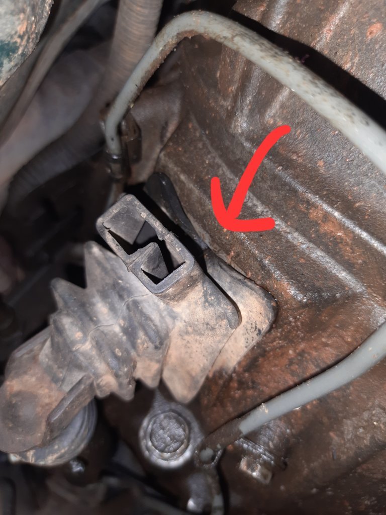

    Hello everyone,
    I notice that this rubber boot that is attached to clutch slave cylinder is kind of peeling off( see image). Should I be concerned about this? Should I get a new rubber boot?

  2. Feb 28, 2025 at 8:05 PM
    MadNachos
    MadNachos Well-Known Member
    Oct 4, 2021
    #378832
    1,109
    2000 Tacoma 4WD Base - no low gas warning light but it has AC!
    Meh. I wouldn't worry.

  3. Feb 28, 2025 at 8:24 PM
    Toyota Dude
    Toyota Dude Well-Known Member
    Nov 11, 2019
    #310447
    164
    2004 Tacoma 4WD 6-CYL DC
    Boot may still be keeping contaminates out of clutch and flywheel that could otherwise interrupt function and longevity.

  4. Mar 1, 2025 at 7:06 AM
    Dalandser
    Dalandser ¡Me Gustan Las Tacos-mas!
    Feb 19, 2015
    #149090
    17,644
    Anthony
    Downey
    08 PreRunner Regular Cab / 98 4x4 Extra Cab
    Empty Wallet Mod
    Yeah that's fine

  6. Mar 4, 2025 at 5:51 AM
    LightsOff
    LightsOff Well-Known Member
    Feb 17, 2025
    #466124
    58
    2000 SR5, V6 4WD
    It may be totally fine but you can check it really easy by popping it out to see if the inner lip is still there. You might be able to just reach your finger inside the drain/vent hole and into the bell housing and press it back into place properly and be done.

  8. Mar 5, 2025 at 2:47 PM
    ControlCar
    ControlCar My Moto: Help & Learn…period.
    Jul 22, 2023
    #429578
    3,581
    Steven
    Sugar Land TX
    1996 Taco 2.4L 2wd Automatic
    Clock Volt meter/LSPV Delete/Hyundai 16’s/FP gauge/after 9months of wrenching ZERO oil leaks
    if no bad tears....
    hit boot with some simple green and get dirt off
    then soak with tht silicon spray(for tires)
    lemme see what its exactly called

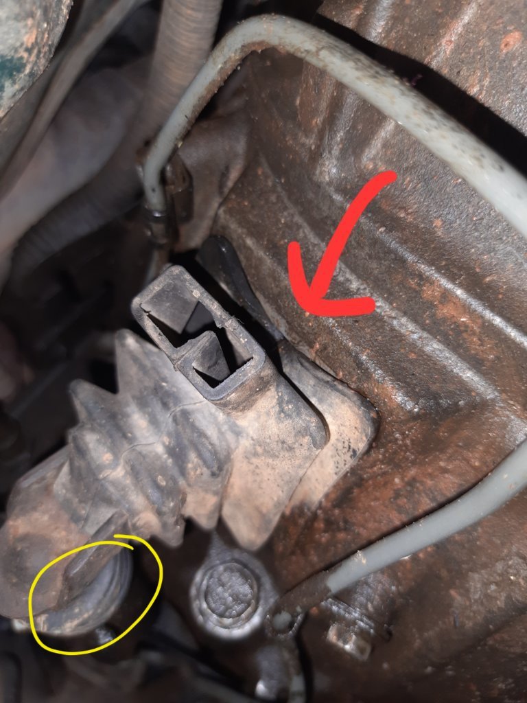

  18. Mar 9, 2025 at 7:04 PM
    #18
    b_r_o
    b_r_o Gnar doggy
    Nov 17, 2016
    #202672
    14,628
    Alex
    WA
    2015 DCLB
    That's actually the clutch fork, not the slave cylinder. The boot is fine, they all look like that. Notice how there's a big rectangular drain hole in it anyway? Water could easily get in under the right conditions..
    If they were that worried they would have put more effort into building a better boot.
    The slave cylinder boot is circled in yellow
    Totaco99[OP] and ControlCar like this.

  20. Mar 9, 2025 at 7:56 PM
    #20
    MadNachos
    Oct 4, 2021
    #378832
    1,109
    Yeah, it's fine, I have run many cars without a boot on the lever covering. If anything it will just let dust out. That area isn't exactly water tight anyway.
