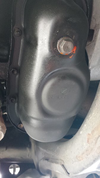

    bluezzy
    bluezzy Love My SuperCharged 07 Sport!
    Feb 3, 2016
    #177007
    2,283
    Monty
    Eugene, Oregon
    I crawled under to see what I could see and found this, remove this?20170302_101139.jpg
  11. Mar 2, 2017 at 10:41 AM
    #71
    Torspd
    Torspd Tor-nication
    Sep 18, 2009
    #22958
    26,433
    Tor
    The Great America!
    MMVI 4.4L 4x4 Access Cab
    Torspd Custom Turbo kit [] Borg Warner 9180EFR Turbo [] Haltech Elite 2500 [] TiAL Q BOV [] TiAL V44 Wastegate @ 15psi [] CP Pistons [] CP Carrillo Rods [] ARP Head studs [] ARP Main Studs [] ARP Header - Head Studs [] Ported Heads w/ 1mm oversized valves intake/exhaust [] Brian Crower Forged Stroker Crank [] Darton M.I.D. Sleeved Block [] Kelford Camshafts [] Torspd 160* T-stat mod [] APR Large Fuel Rail [] Walbro 460 LPH E85 Fuel Pump [] FueLab FPR [] APR T56 Conversion Kit [] KP RACING Built T56 [] McLeod Racing Custom Twin Disk Clutch [] One Piece Aluminum Driveshaft [] MGW Shifter [] Custom lowering kit [] Ohlins Front Coilovers [] QA1rear shocks [] Custom Ron Davis Radiator [] Dual SPAL Electric Fans []
    It is where the bell housing mates to the back of the engine.
  12. Mar 2, 2017 at 11:11 AM
    #72
    Torspd
    Torspd Tor-nication
    Sep 18, 2009
    #22958
    26,433
    Tor
    The Great America!
    The opening is visible in your picture. Behind the oil pan.
  13. Mar 2, 2017 at 11:19 AM
    #73
    bluezzy
    Feb 3, 2016
    #177007
    2,283
    Monty
    Eugene, Oregon
    Well, I have changed out plenty of clutches and transmissions in my day so I kinda know what I'm doing... I cant see anything through that little hole... must be getting old or something... ;)
