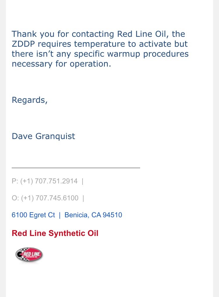

    Not entirely true. Warmup procedures are not specific but BITOG discussion suggest 2500rpm Max is reasonable for gentle warmup of engine. I went and asked a representative of Redline Synthtic Oil Co. And this is what he had to say.
    (Name deleted),
    Thank you for contacting Redline Oil, the ZDDP requires temperature to activate but there isn't any specific warmup procedures necessary for operation
    Regards,
    Dave Gronquist
    A quick Google search brings up ZDDP activation range between 60-120°C

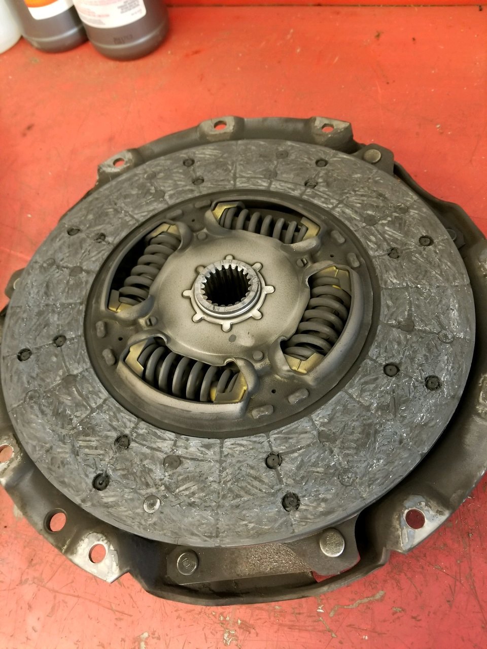

    Mine did this for the first time the other day. I'm at around 10K miles.
    Freaked me out because it did it as I was leaving a neighborhood and pulling onto a very busy street. I've never had a clutch act like that unless something was wrong, but it did go away. The weather is supposed to turn much colder and drier here soon, so we'll see if it does it again, or if it was moisture.
    It better not be looking like this:
    [​IMG] [​IMG]
