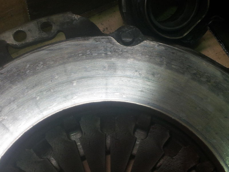

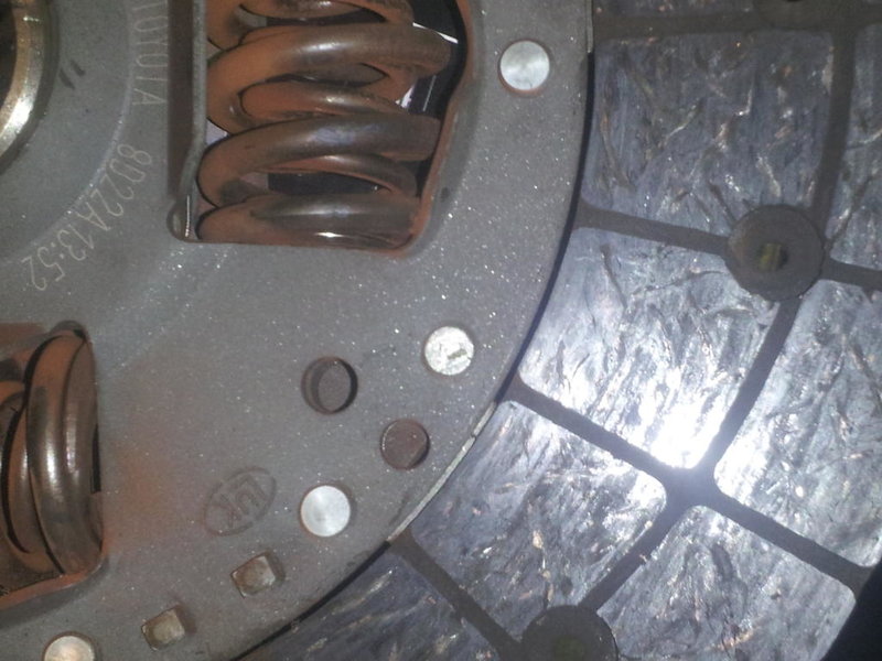

    My 2009 is way out of warranty. At 23,000 miles my clutch began slipping. I replaced it yesterday. It was a LUK. The pressure plate was also LUK. (of Mexico) It actually wasn't worn out. It was glazed. The pressure plate had some blueing. I replaced it with a Chinese kit. Time will tell if it's going to last more than 23,000 miles. I've been told that ALL clutches are made in either Mexica or China because of the dangerous materials...I've used a "Perfection" kit. The fit and feel are fantastic and it was about $160 complete.
