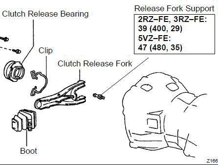

    Where are you exactly spraying this?
    Picture? Diagram??
    I just pulled that boot back and sprayed to where I thought the ball is on the pivot

    From another user (EquinsuOcha):
    There's a ton of information on this subject. Search for "clutch squeak" and you're sure to find what you're looking for...
  9. Aug 11, 2010 at 5:45 PM
    Ramphonic
    Ramphonic [OP] Well-Known Member
    Jul 28, 2009
    #20274
    217
    Cape Cod
    2k1 SR5 4x4 V6
    Adjustable Bilstein, AAL Lift, Eagle Rims with BFG ATs, Trd Exhaust, Clear Corners, Red Clear Tails
    I actually saw those pics but it didnt really help. I pulled the black boot back (where the pink mark on the tranny) and shot the white lithium about halfway down the clutch fork.

    That is exactly what I did and it worked for me. Maybe try again? I don't mean to insult your intelligence, but are you sure the squeak is coming from the tranny? I had a squeak from both the tranny and the clutch pedal assembly. You may want to get a set of ears under the truck as you push in the clutch to make sure it's coming from the tranny.
