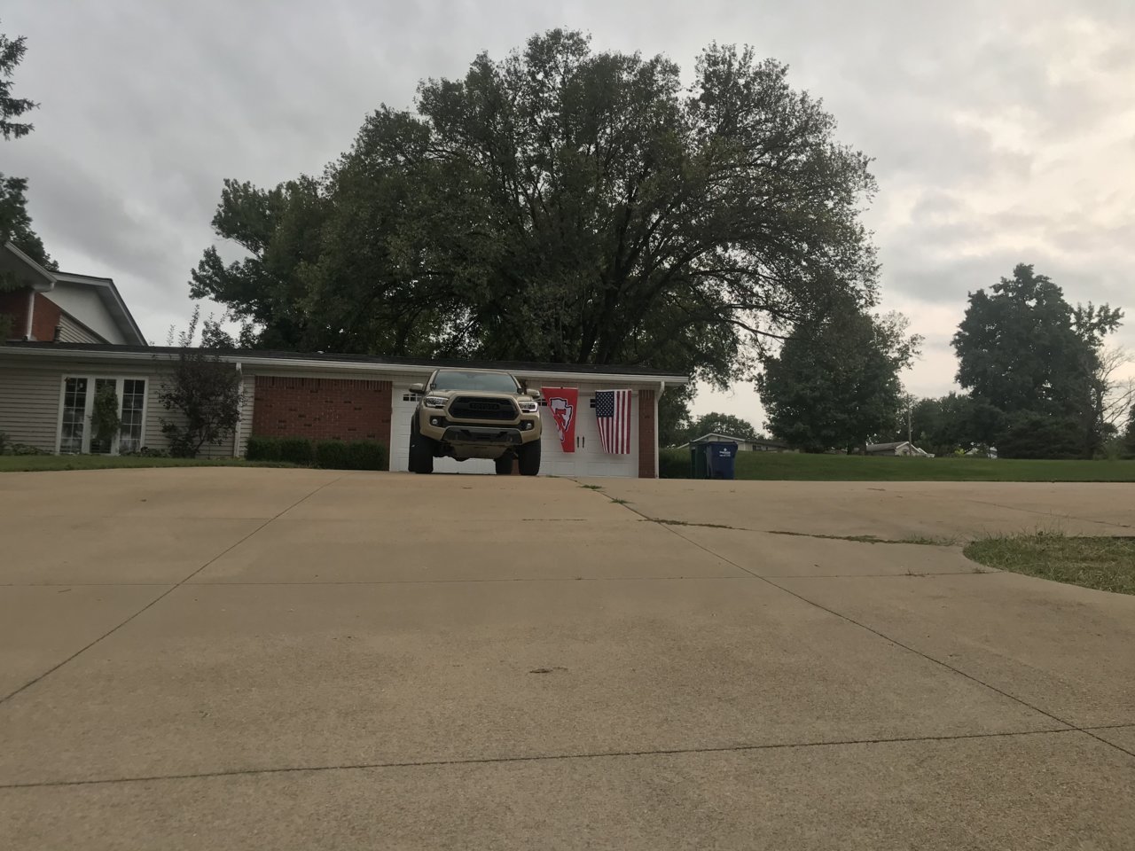

    8FBF4B1C-BF08-477F-A8A2-34F5463EA838.jpg Shoot it won’t even get me up my driveway
