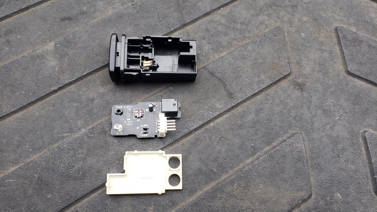

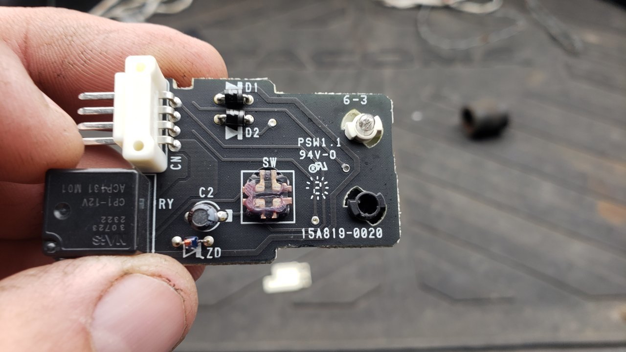

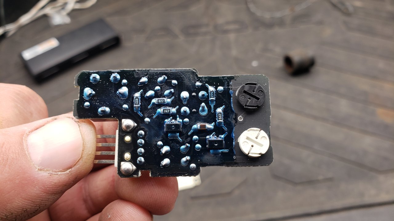

    I just decided to take mine apart, quite a sophisticated little board in there for a switch.
    I think I found the problem, they used a extra thick and pasty grease on the contacts, I bet when it gets cold the grease is too thick to make a connection.

    Well………. Now you’re left with what type grease to use.
    Conventional or Synthetic :duh:
    BTW, I had a suspicion you’d actually take it apart:thumbsup:
    Thanks for sharing, definitely an interesting switch.

    It looks like the solder holds up better than the overhead temperature gauge.
    I think a lot of it has to do with the heat on the roof, the solder broke on the little resistor on mine.
    Anyways, what is the black “socket” for next to the white one for the bulb?
    It looks empty? Maybe used for something else too on another model?

    I'm guessing for the backlight, I've never paid attention if it lit up or not I'll have to look.
    The white one is the indicator light.
